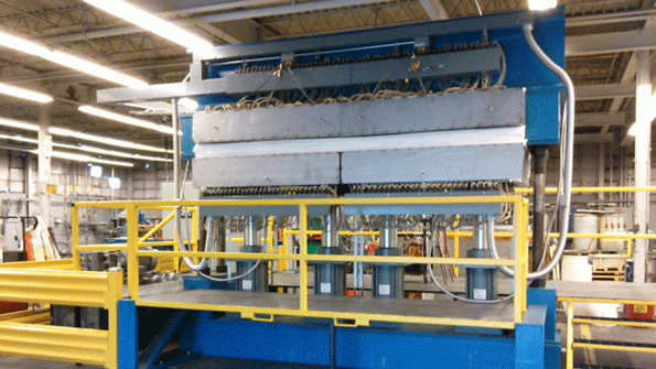

The company needed a new press to manufacture long, narrow parts of the metal—up to 28 in. by 128 in.—and Maintenance Manager Sam Moore decided it should be capable of pressing two parts at the same time. As a result, four hydraulic cylinders were used, two for each end of the press (Fig. 1). For pressing the longest parts, all four cylinders would be used for the cycle. If shorter parts were to be used, the system could be split and operated as two independent presses, with two cylinders each.
1. The Missouri Metals titanium press is capable of pressing two parts at a time. Each side of the press uses two hydraulic cylinders to ensure that pressure is evenly applied.

The four cylinders in the new Missouri Metals titanium press are mounted beneath the lower platen (Fig. 3) and push vertically up to close the press, which can operate in two modes: full platen (to press a single, very long part) and split platen (to independently press two parts).
