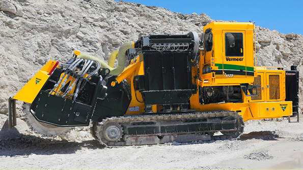

Vermeer’s T1255III Terrain Leveler surface excavation machine uses hydraulics for propulsion, steering, braking, and rotating and positioning its cutting drum.

The Terrain Leveler SEM features a patented tilt-head milling attachment with top-down cutting action that can dig up to 21 in. (53.3 cm) deep and 144 in. (365.8 cm) wide in a single pass—all with hydraulics. Hydraulic cylinders can tilt the drum ±5 deg. while a low-speed, high-torque hydraulic motor rotates the drum. As the unit travels forward with the drum rotating, the teeth on top of the drum advance over the top of the mineral surface. Operators can also control material sizing by increasing or decreasing the tooth penetration—again, by controlling the stroke of hydraulic cylinders. Uniform product size also allows for more efficient settings on secondary and tertiary crushing systems.
The direct-direct drive version of the machine has a fully hydrostatic motor mounted to the side of the cutting head to provide rotational power directly to the cutting drum. The end result is high efficiency and productivity when working in hard rock conditions. The direct-drive drum rotates at 18 to 26 rpm to cut an 80-deg. high wall, providing slope stability that is important in high-wall mining operations. When surfaces must be worked right up to the edge of a wall, Vermeer offers a twin chain-driven (each powered by a low-speed, high-torque motor) drum. This arrangement lets the quarry operator to cut a 90-deg. high wall and control drum speed from 25 to 36 rpm.
The T1255III is propelled and steered though a crawler drive with dual independent hydrostatic tracks boasting counter-rotation capability. This means the operator can quickly reposition the machine 180 deg. in either direction by simultaneously rotating one track forward and the other backward.
