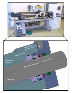

To examine and compare the two most common types of buffer seals—high-sealability and friction optimized seals—and the parameters that extend their service lives, engineers developed a test rig that covers all application parameters to get an overview on seal performance.
What was learned during these investigations should help engineers understand the seal types and the interactions between seals so they can better specify the most appropriate ones for their applications.
Gathering Data
The test-rig consisted of a pressurized test cell, a piston rod, an electrical drive and a hydraulic pressurizer. The hydraulic oil had a viscosity class of 46. An additional pressure sensor was installed between buffer and primary rod seals to investigate possible intermediate pressures.
Test Protocols
During verification testing, five buffer seals were examined:

The tests were done in four phases:
Running-in phase, to set up constant starting conditions for each seal to guarantee correct comparisons.
Pre-performance phase, to evaluate characteristics such as absorbing pressure spikes and time to build up intermediate pressure.
Long-term phase, to evaluate characteristics such as wear and extrusion resistance.
Post-performance phase, to evaluate characteristics as the seals age.
The testing parameters include several different pressure and piston rod velocity cycles, with pressures and piston rod velocities set so that pressure was low when speed was high and vice-versa. This mimics an operating excavator; the high loads are mostly at low operating speeds, and the higher speeds go with low loading.
