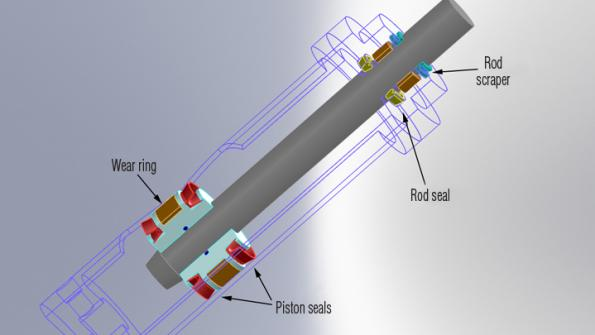

Among the popular sealing materials the polymer, polytetrafluoroethylene (i.e. PTFE), has been recognized as an ideal choice for enhancing critical hydraulic and pneumatic equipment performance in demanding applications. PTFE was originally used as a chemically resistant component of nuclear valves and seals. Readily machined, compounded PTFE components are preferred in areas where elastomeric seals cannot meet the frictional, temperature, or chemical resistance requirements of the application. Sealing components in which wide temperature ranges and corrosive environments demand a specific PTFE based solution include:
Rod wiper seals— These ensure the rod and cylinder are kept clean and free of foreign matter. The low coefficient of friction, resistance to chemical attack, non-marring surface of PTFE serve this application well.
Bearing guide strips— PTFE wear strips align, stabilize and reduce radial movements of a cylinder’s piston rod from side loading. (Insert “StripBearings.jpg”)
Piston and rod seals— Piston seals from PTFE are designed to prevent fluid from passing over the piston as the system pressure forces the piston through the cylinder bore. Rod seals contain pressurized fluids from leaking out of the system during bi-directional linear motion
Backup rings— Backup rings are typically used to insure a primary elastomeric o-ring or lip seal remains fixed in place during assembly and operation. Generally two backup rings are used per primary seal. For equipment operating at higher temperatures and pressures and in fluid systems, the benefits of PTFE backup rings are valued when long residence times are desired.
Ball valve seat rings— This seal requires the use of materials with chemical resistance, low coefficient of friction, and wide temperature range and is therefore ideally suited for PTFE. Seal engineers design the seat to offset the less desirable properties of PTFE, such as high coefficient of expansion, poor heat transfer and resistance to cold flow.

Bearing guide strips— Bearing guide strips serve an important function in a hydraulic cylinder in aligning, stabilizing and reducing vertical movements of the rod due to transverse loading. Usually two guide strips are installed per piston.In a jack hammer application originally installed with bronze bearing guide strips, premature seal failure occurred as a consequence of heat buildup due to the applications short stroke and rapid action in an abrasive environment. Replacement of the bronze strips with a bronze filled PTFE bearing guide strip provided at least triple the service life, due to improved wear resistance regardless of elevated temperature. From a lubrication point of view, the self-lubricating PTFE guide tape readily exceeds metal-based bearing guide strips by also preventing wear due to metal-to-metal contact. Depending on the application, compounded PTFE wear strips can be produced to specific dimensional requirements and commercially available in continuous or individual lengths.
Energized seals— PTFE bodied seals are composed of a machined PTFE housing, bolstered by a temperature and corrosion resistant energizer, composed of rubber or a compressible metal ring. In addition, the PTFE housing itself can serve as an energizer, eliminating the rubber or metal component. When the seal is installed in the gland, the compressed energizer applies force on the sealing surfaces, creating a tight barrier to prevent gas or fluid leakage. The continuous force of the energizer provides resiliency to compensate for seal wear, gland misalignment or eccentricity. While energizer force provides adequate force for sealing at low pressure, at high pressure the system pressure reinforces the energizer force, resulting in an even tighter seal. In a Bauxite mine, a fast stroke hydraulic system on a rock crusher, was failing due to contamination of the hydraulic fluid caused by wear and of its HNBR elastomer piston seal. Able to withstand the abrasive wear and higher temperatures associated with the dynamic friction, replacement with self-energized PTFE bodied seal eliminated the frequent replacement of HNBR based seals
