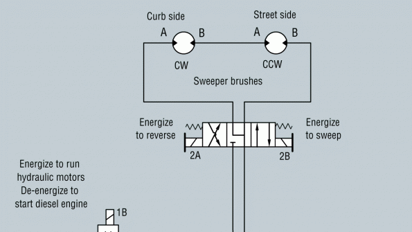

off trash hauling trucks and flatbed trailers. One contractor complained that his sweepers were breaking down frequently due to their hydraulic motor shaft seals failing. The part of the circuit for the brush motors is shown. The motor on the curb side seemed to fail more often than the one on the street side.

A manufacturer’s catalog stated that the sweeper’s hydraulic motor was “especially suited for low-flow, high-pressure applications.” It also stated: “High pressure Viton shaft seals eliminate the need for a case drain.” System pressure in the sweeper’s hydraulic system would fluctuate between 1500 to 2000 psi, and the rated continuous pressure listed in the catalog was 3000 psi. The system relief was set to 2400 psi. The catalog suggested a particular model for bi-directional applications, which was the case for this equipment.
At first, the contractor ordered shaft seal kits, then started ordering new units because he thought his maintenance people might not be installing the seals properly. But failures still occurred.
Any idea why the shaft seals were failing?

Failing motor shaft seals are usually caused by high pressure or pressure spikes. In addition, dirty oil contaminants can embed themselves in the rubber-like seal material and actually grind a grove in the steel shaft causing excessive clearances and leaks.
The rotation on most hydraulic motors can be reversed by switching the port connection plumbing without resulting in any change in performance. However, several motor manufacturers like Parker and White Hydraulics, ( to name a few), offer motor designs where switching the ports to reverse the motor rotation has limits. For example, White Hydraulics offers a motor that they say is a: “Perfect compromise between price and performance by producing work horse power at a reasonable price.”
These types of motors are fine if the application fits their design. The New Orleans contractor with several pavement sweepers had several motors in stock and was not aware that switching the inlet port plumbing to reverse the motors would cause premature shaft seal failures rotating in one direction and normal life rotating in the opposite direction.
The original circuit called for clockwise and counter-clockwise motors both with the “A” port as the inlet. The physical motors are identical except for an internal plate and one number in the model code. Once the correct arrangement was restored, the shaft seal problem was resolved.
