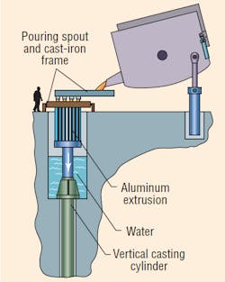

In aluminum foundries, a self-guided hydraulic cylinder with non-rotating rod is mounted vertically under a casting tool to provide smooth lowering of the new castings and tooling assembly. Although this may not sound like a particular challenge, the tooling assembly with castings may weigh up to 160 tons, and the cylinder often is submerged in water, which cools the tooling and castings.
Aluminum casting plants often incorporate a hydraulic cylinder to move molds downward during a pour.
One of the most versatile characteristics of hydraulics is the ability to place a compact actuator in a remote location — with only a hose or two leading to it. That’s exactly the case often found at aluminum foundries. In these applications, a self-guided hydraulic cylinder with non-rotating rod is mounted vertically under a casting tool to provide smooth lowering of the new castings and tooling assembly. Although this may not sound like a particular challenge, the tooling assembly with castings may weigh up to 160 tons, and the cylinder often is submerged in water, which cools the tooling and castings.
