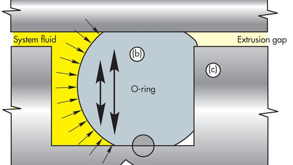

Figure 1. (A) Seal material must conform to irregularities in metal surfaces to block fluid passage. (B) To adjust to clearance-gap size changes, the seal must expand or compress rapidly to follow dimensional variations. (C) To resist being forced (extruded) into gaps, the seal must have sufficient modulus and hardness to withstand shear stress produced by system pressure.
Effective seals need to perform three basic functions:
Seal — sealing elements must conform closely enough to the microscopic irregularities of the mating surfaces (rod-to-seal groove or piston groove-to-cylinder bore, for example) to prevent pressure fluid penetration or passage (Figure 1);
Adjust to clearance-gap changes — the seal must have sufficient resilience to adjust to changes in the distance between mating surfaces during a cylinder stroke. This clearance gap changes size because of variations in the roundness and diameter of the cylinder parts. The clearance gap also may change size in response to side loads. As the size of the gap changes, the seal must match the size change to maintain compressive sealing force against adjacent mating surfaces; and

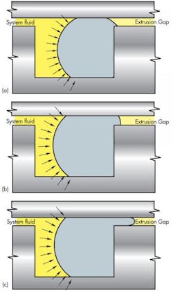

Resist extrusion — the seal must resist shear forces that result from the pressure differential between the pressurized and unpressurized sides of the seal. These shear forces attempt to push the elastomeric seal into the clearance gap between adjacent metal surfaces (Figure 2). The seal must have sufficient strength and stiffness to resist becoming deformed into the gap and damaged or destroyed.

The seal’s internal shear stresses increase as system pressure increases. With increasing pressure, the stresses eventually exceed the physical limits of the seal elastomer, and it extrudes into the gap. Difficulties presented by high pressure are not primarily sealing problems, but are problems of keeping the seal in its gland while maintaining its structural integrity as increasing system pressures force the seal into the gap.
Figure 2. As system pressure increases from (A) to (B), an O-ring seal is progressively forced into an extrusion gap. Once the material has flowed into the gap, (C), permanent damage has occurred.
Almost all of the design and in-service technology of high-pressure sealing deals with protecting the elastomeric seal from the potentially destructive distortion caused by high system pressures. With proper backup to reduce the size of the gap, relatively fragile elastomers can successfully seal extremely high pressures.
