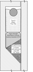

For extreme pressures in one direction, a three-part sealing system, Figure 6, is recommended. The seal is made of a Type B PolyPak, backed by a filled-polyamide modular backup beveled at 30°. A wedge-shaped, skive-cut split-ring, machined from ductile bronze or brass, is placed behind the beveled modular backup. The metal backup and seal groove are mated at a 45° angle. Under pressure, the wedge-shaped metal ring expands to close the extrusion gap. This design has operated successfully at pressures to 100,000 psi in a specialized application for making synthetic diamonds.
Compressed by the elastomeric urethane PolyPak, this elastoplastic modular backup expands radially to fill the groove and prevent sealing-element extrusion. Without an additional anti-extrusion device, the elastoplastic modular backup would experience plastic flow into the gap at 100,000 psi. A softer, lower tear-strength urethane back-up element would be nibbled or cut by the metal backup ring especially where the metal ring is split.
Figure 6. At extreme pressures, a metal anti-extrusion device of ductile bronze or brass and a high-strength, high-durometer modular backup ring is required.
