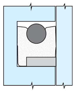

An enhanced polyurethane seal with a glass-filled polyamide anti-extrusion ring, (Figure 2) can be used successfully at pressures to 10,000 psi.
2. A positively activated seal of modified urethane with a backup ring of Nylatron can seal fluid pressure to 10,000 psi.

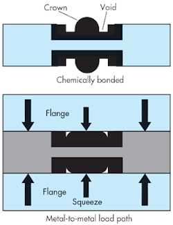

Squeeze
In general, a seal component is installed in a groove machined into one of the surfaces to be sealed. When two surfaces come together to form a gland, they squeeze the diametral cross-section of the seal. The mechanical squeezing action deforms the seal cross-section; the degree of deformation obviously is a function of the squeezing force.
In low-pressure applications, the tendency of the squeezed elastomer to maintain its original shape creates a seal. As the elastomer shape becomes deformed in its gland, it exerts a counter force against the mating surfaces equal to the force squeezing it (Figure 3), and hence, provides the available sealing force.
3. Shown is a simple representation of how squeeze force compresses a combination gasket/O-ring seal during gland assembly.
Thus, squeeze is a major low-pressure consideration. The recommended squeeze levels are a function of seal cross-section, the application conditions, and whether the application is dynamic or static. Dynamic compression typically is lower than static compression, due to seal wear and friction considerations. Table 1 summarizes dynamic squeeze levels as defined by MIL-G-5514G — a document that’s a good guide to those parameters. Static data in the table is summarized from common industrial practice.

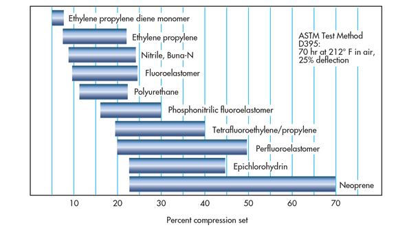

Compression Set
Compression set reflects the partial memory loss due to the time effect. In hydraulic systems operating over extreme temperature ranges, it’s not uncommon for compression-type seals, such as O-rings, to leak fluid at low pressure due to permanent deformation or the fact that they took a set after being used for a period of time.
The term compression set refers to the permanent deflection remaining in the seal after complete release of a squeezing load while exposed to a particular temperature level. As related to low-pressure sealing, set — the loss of memory — reduces the compressive sealing force.
Compression set is expressed as a fraction of the initial squeeze. Thus, a 0% compression-set value indicates complete recovery from a compressive load, producing the maximum possible compressive sealing force. A 100% set value indicates no recovery or rebound at all. A seal in this condition will no longer provide a sealing force and, therefore, has no ability to act as a low-pressure seal. Figure 4 depicts the range of typical compression set values for various sealing elastomers.
4. Percentage of compression set varies among typical families of sealing elastomers used in fluid power systems.
Of course, compression-set properties are a major, but not the only, factor affecting elastomer choice for low-pressure sealing. Compatibility with various hydraulic fluids must be considered as well.

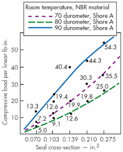

Sealing force
Several factors affect the sealing force, including material hardness, percentage squeeze, and seal cross-section size.
For a certain amount of squeeze, the sealing force is directly related to the hardness or elastic moduli of seal materials for low-pressure applications. The harder the material, the larger the initial sealing force. A seal material’s nonlinear stress-strain curve needs to be described by special material models. For simplicity, linear moduli, such as Young’s modulus and shear modulus, are typically used due to their direct relation to the material hardness. The modulus commonly employed for specification purposes is tensile stress at a specified elongation. For example, modulus at 100% elongation is the tensile stress corresponding to that elongation.
For the most part, a durometer gauge measures hardness— typically using the Shore A scale. The gauge measures the force required to deflect the flat surface of a rubber specimen with a pointed indicator. The A scale ranges from 0 to 100; a 90 Shore A compound would be designated as a hard (or high-viscosity) material and exhibit much higher compressive force than a 60 Shore A compound, which would be classified as soft.
For a specific material, seal compression force of the elastomeric material increases as the percentage deflection of the seal’s diametral cross-section increases. Dynamic squeeze levels typically should be limited to around 12% due to friction and related-wear considerations. Static squeeze levels can be as high as 30%.
It generally is recommended that a minimum of 0.009-in. squeeze be induced on radial seal cross-sections due to compression set considerations. Maximum radial squeeze should be held to 30% because greater squeeze causes assembly difficulties and elastomer deterioration. Compressive sealing load also directly relates to the size of a seal’s cross-section (Figure 5).
5. These plots illustrate compressive load vs. O-ring seal cross-section for three different seal material hardnesses.
