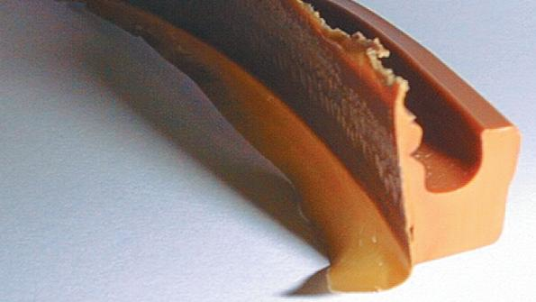

Figure 1. Heat and motion combined to damage this seal. After excessive heat softened the seal material, rod motion dragged both the lip and heel into the extrusion gap. Click on image for larger view.

It is difficult to rate seal materials for a certain differential pressure, because that rating is affected by the extrusion gap, the motion, and the temperature. (In addition, seals in static applications usually will be able to contain two to three times as much pressure as the same seals under the same conditions when dynamic motion is introduced.) Higher temperatures lower the material’s modulus of elasticity and, consequently, its resistance to extrusion, Figure 1.

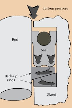

Installing backup rings made of poly-ether-ether-ketone (PEEK) or brass is one way to deal with extremely high pressures. To close the extrusion gap mechanically, use a positively actuated backup. These backups are placed in the gland in such a way that they are pushed closer to the sealing surface by the downward force exerted by pressure, Figure 2. The higher the pressure, the greater the force that holds them against the sealing surface and in front of the extrusion gap. Positively actuated brass backup devices have contained pressures exceeding 90,000 psi under static conditions. Their 0.025-in. radial clearance proved insignificant.

Figure 2. Pressure on seal mechanically moves wedge-shaped backups to close extrusion gap. Click on image for larger view.
