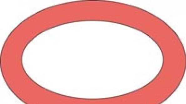

O-rings are the most commonly used seals in fluid-power systems. However, elastomeric O-rings are unlike most of the materials that engineers and designers encounter. The reason: O-rings must deform to function properly.
As the name implies, O-rings are shaped like a doughnut. (Torus is the geometric term.) They are installed in cavities known as glands and then compressed. The resulting zero clearance within the gland provides the seal that blocks the flow of liquids and gases. This simple arrangement serves many fluid-power systems very well, but success still requires careful design, selection, and installation procedures.
