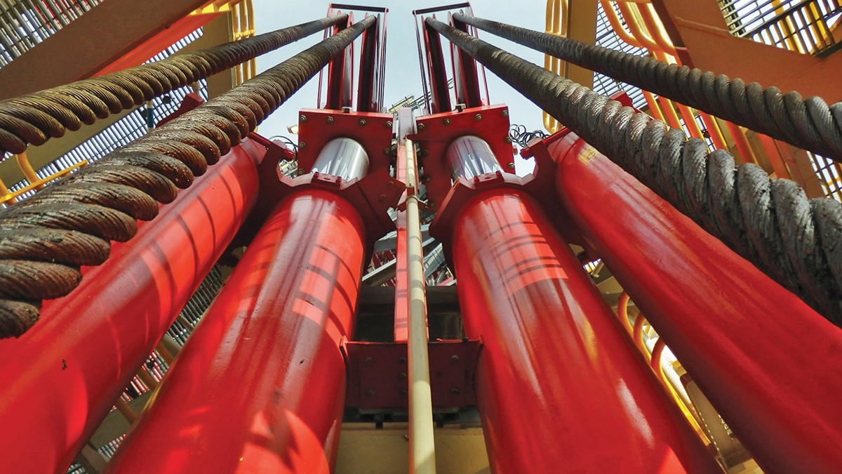

The tensioner cylinders used to support subsea drilling and production risers where they connect to the rig are the size of an 18-wheeler. They are in motion 24/7 and must accommodate 50-ft strokes during storms. With a cost of up to $100,000 to ferry one onshore for refitting and return it to the rig (not including lost production costs), it’s little wonder rig operators insist that every cylinder they install lasts at least 10 years.

Additional to the seal system, and equally important, is the wear ring and rod scraper system. Tensioner cylinders are subjected to high side loads, so keeping the rod and piston concentric with the seal is essential. The wear rings used must be strong enough to resist deformation under dynamic load and resist swell from water absorption, preventing metal-to-metal contact with the cylinder’s metallic components.
