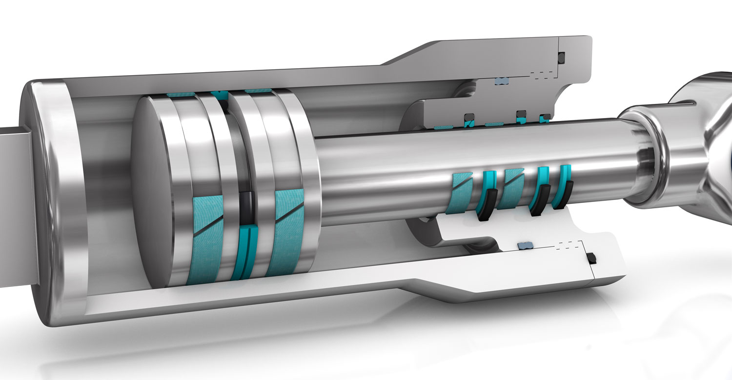

Rod Sealing
Leak-free performance and high service life cannot be ensured by a single sealing element in heavy-duty applications. Because the cylinder’s piston rod is directly exposed to the environment, it’s paramount that the seals keep the fluid in the system. External leakage is easily noticed. Not surprisingly, then, it has become a common criticism of hydraulic power transmission.
The solution is redundant systems that involve specially developed seals arranged in a series, often referred to as in tandem. Each sealing element in such systems has a specific function, and their interaction is critical to a high-functioning system.
This illustration shows a variety of piston rod seals to make an effective sealing system. At left and center are tandem wear rings, at far right is a rubber-energized double-acting scraper seal, and the other two are single-acting O-Ring-energized rod seals.
Two main configurations are recommended for tandem sealing systems. The first is a vented unidirectional polytetrafluoroethylene (PTFE) slipper seal with either a unidirectional PTFE or polyurethane slipper seal as the secondary seal. This configuration has the advantage of limiting micro fluid-film formation under the seal and ensuring that when the rod is retracted, the sealing face supports hydrodynamic back pumping of the fluid film. This results in leak-free sealing with low friction for decreased wear. Additionally, the secondary seal materials described above provide superior sliding ability with maximum wear resistance.
The second configuration is a buffer seal, which has an integrated backup ring and a polyurethane U-cup as the secondary seal. This arrangement is usually more cost-effective than the first option and may suffice for systems requiring high abrasion resistance or where pressure will continually fluctuate between high and low pressure. A modified version of the buffer seal also can be used to provide lubrication for the U-cup so it does not run dry.
Rod scrapers—Contamination of the hydraulic fluid is the most common cause of damage to seals, rings, and other components. O-ring energized scrapers and double-lipped polyurethane scrapers are recommended for dynamic sealing systems, with the choice depending on the type of contaminants expected and the friction and stick-slip requirements of the overall system.
O-ring energized scrapers are composed of PTFE or another thermoplastic material and are installed with an elastic O-ring in one groove. The O-ring maintains the pressure of the scraper lips against the sliding surface, which compensates for deflections in the piston rod and allows effective scraping of contaminants—even firmly adhered dirt.
Double-lipped polyurethane scrapers are superior to conventional elastomeric scrapers, with a scraper lip designed to effectively remove dirt while leaving the oil film required for correct operation. The sealing lip faces inward to assume a sealing function under low pressure, and the static seal is achieved by a tight radial fit between the scraper body and the groove.
