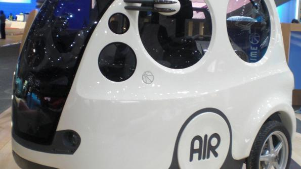

A golf cart? Maybe. But you just can't store enough compressed air to give a car any appreciable range. I haven't crunched the numbers, but this video explains that one of the leading air car prototypes uses three cylinders of compressed air at 300 bar (roughly 4350 psi). The cylinders are made of a carbon fiber composite for light weight. The car's engine and frame are made primarily of aluminum, also for light weight. The video doesn't mention how safe such a vehicle would be in a collision. The host does mention that the composite cylinders would be safer than steel ones, but I wouldn't want to be anywhere near that much stored energy being released in an instant.
The host also mentions the car will have a range of about 200 km (just over 124 mi), and top speed would be about 110 km/hr (a little over 68 mph). This might be fine for driving to and from work, and running a few errands under ideal conditions. But most commutes and errand running involves conditions that are far less than ideal. You'd have a lot of stop-and-go traffic, hills, and inclement weather. Furthermore, you'd frequently need air conditioning or heat, which would substantially reduce range. Even windshield wipers would reduce your range.
You'd still need some sort of variable transmission to provide enough torque for decent acceleration from rest and also provide enough rotational speed for highway travel without gobbling up all the compressed air within a few miles. And don't forget, you'd need electricity for lights and such, so you'd have to tap into the compressed air to drive a generator — another drain on range.
The host mentions that the air car might incorporate a small internal combustion engine to increase acceleration. This implies that the vehicle would be more of a dog than the '63 Corvair I had as a teenager. (That thing wouldn't even burn rubber on wet leaves.) The website of MDI Enterprises mentions that some versions of the air car would incorporate an internal combustion engine for highway driving. Again, this confirms that a car powered by air alone cannot meet the requirements of today's typical car.
