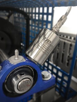

“With COVID-19 and with the lockdowns, we started to see a bigger shift into remote monitoring,” said Miller. “That’s especially the case with our newer systems, where a cloud-based system can monitor the bearing wear effectively, but also have a single-point lubricator attached.” Technicians now receive notifications on their mobile phones alerting them that a bearing needs lubrication. And with the click of a button, they’re able to lubricate the bearing from anywhere.

That a lot of data is required in order to use ultrasound in AI implementations is a misconception, pointed out Miller. This is due to the simplicity with which one can diagnose the health of a bearing. An ultrasound analysis will demonstrate the health of a bearing based on the sound of the bearing.
“Firstly, a rolling element bearing will have the same characteristics whether it is a large bearing or small bearing, a low-speed or high-speed bearing,” explained Miller. “Secondly, historical trending is used,” he said. In other words, the frequency can be tested periodically to test the bearings and develop a trend. As that trend develops, technicians may set alarms to appropriate levels and take action.
Setting the baseline is simple—it is marked by setting the first reading. The majority of the time, said Miller, engineers will find their bearings are good and, if they are attuned to it and the sound is off, they can take corrective course immediately. Ultrasonic instruments can record sounds and allow engineers to do spectral analysis, which indicate such defects as harmonics, inner-race, outer-race, ball pass frequencies and misalignment.
Thirdly, Miller said, comparison methods (comparing the sound of one bearing against that of another) may also be used to understand the health of a bearing.
