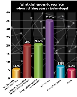

Although the use of sensors has become more common within the fluid power industry, there are still many challenges faced by the design teams utilizing them. One of the top challenges noted by 21% of survey respondents is the fact that many sensor options remain too expensive. Although their costs have come down in recent years, they can still be a costly part of a system design depending on the type of sensor required and any ruggedness or other aspects which may need to be built into it.
Another 20% of respondents said difficulty integrating sensors into their designs remains a challenge while 6% said not knowing what type of sensor to use can be challenging. Both are important aspects to ensuring a sensor meets the given application and measurement requirements.

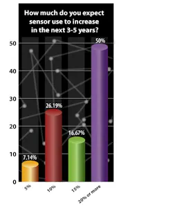

Fifty percent of respondents expect sensor use to increase 20% or more over the next 3-5 years, followed by 26% anticipating a 10% increase in use.
