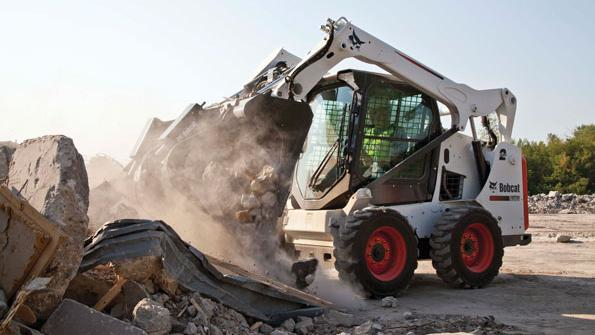

For more than 50 years, Bobcat skid-steer loaders have represented durability and reliable performance for construction, landscaping, and agricultural applications.
For more than 50 years, Bobcat skid-steer loaders have represented durability and reliable performance for construction, landscaping, and agricultural applications. The key to a dependable loader is to have properly balanced horsepower and hydraulics so operators can work efficiently in rugged conditions. With an eye to continuous product performance and reliability improvement, Bobcat recently invested in an Engis bore finishing system, which not only improved the quality of a key hydraulic component, but increased manufacturing throughput 300%.
