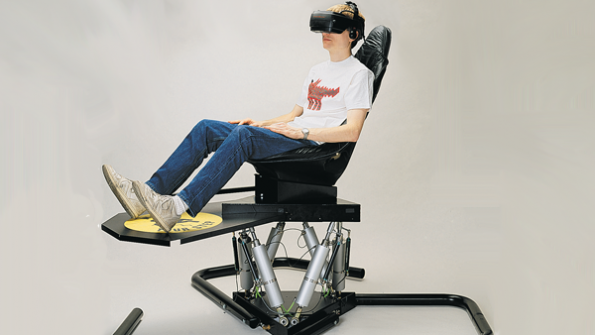

Figure 1. Virtual-reality participant sees computer-generated surroundings in headset. The motion base moves seat according to commands from software and input device, such as a joystick; the view in the headset changes according to software, head movements, and motion base movements.
To demonstrate compliance, if the motion base is powered, but no signal is provided by the joystick, the motion platform assumes a level position. If you suddenly jump onto one corner of the platform and hold on, the platform will dip, but then right itself. When you jump off, that corner rises, but the platform again quickly rights itself back to its level, equilibrium state. This is what makes the motion base seem alive. In contrast, jumping onto a stiff hydraulic or mechanical motion base would have little or no effect on the position of the motion platform.
Subsequent modifications and improvements eventually led to what is now the Cyber Air Base, Figure 1. Currently, the Cyber Air Base produces 6-axis motion in conjunction with a number of audio-visual programs for simulation and virtual reality (VR) entertainment. VR is the next step beyond simulation. In simulation, you are a passenger in a predetermined journey. It’s fun and exciting, but in VR, you become the pilot or driver, not just a passenger. You control where you want to go, when, and how, so no two experiences are ever exactly the same — and they are usually unpredictable, which fits perfectly the character of the Cyber Air Base.
