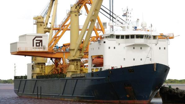

Figure 1. Hydraulic cylinders and other critical components used in marine environments can benefit from new steels that offer distinct advantages over widely used ASTM 316 and 316L stainless steels.
