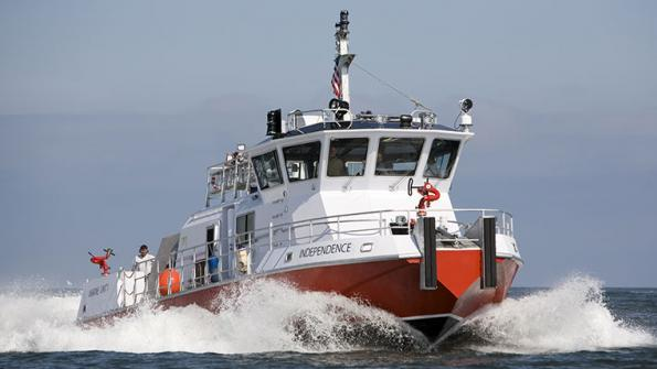

The Independence, a fire and rescue boat, has a navigation mast mounted to the top of its pilot house that pivots downward when the vessel must pass under a low clearance. The mast is pivoted 180° by a helical rotary actuator. ...
Considering that more than six million people live in the Philadelphia region, government officials realized they needed a fast-response emergency river vessel with both fire fighting and rescue capabilities for any type of emergency it may encounter. Philadelphia officials turned to Derecktor Shipyards, New York, to manufacture the Independence, a 2000-Class Fireboat, which was christened in December 2007. Established in 1947, Derecktor Shipyards builds a variety of commercial vessels and custom mega yachts for customers around the world.
The waterways around the Philadelphia region pose a significant and serious set of obstacles that needed to be considered when designing and building the Independence. With regional responsibilities from as far north as Trenton, N. J. and as far south as the Delaware Bay, the Independence would find itself in water depths as shallow as 30 in. Furthermore, some of the waterways are very narrow, so the Independence can make 360° turns.
The Independence is powered by four 825 hp engines, allowing it to achieve speeds of 36 knots. Its fire fighting arsenal includes a water pump capable of 5500 gpm and 200 foam tank capacity. It also has a 16-ft rescue boat, and its galley can be converted into a trauma unit complete with advanced life support equipment.
However, the greatest challenge may have been the height. Many bridge structures in the area only allow vessels with an air draft 18 ft to pass underneath. Air draft is the distance from the water surface to the upper- most point of a vessel. Therefore, keeping the air draft of the Independence less than 18 ft was imperative to its safe travel and access to all areas within its range.
