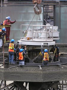

Hydraulics drives clarifiers
Just about any municipal water treatment plant uses clarifiers to remove suspended solids from effluent. A clarifier consists of a round basin — usually 65- to 80-ft in diameter — with an arm that slowly rotates around the center to gently push the sludge that collects at the bottom of the basin into a drain. From there, the sludge undergoes a dewatering processes and typically is burned or transported for disposal in a landfill. As landfill space continues to dwindle, however, this sludge increasingly is used as compost. Its value as compost helps offset costs for transportation to a final destination - which is not the case when it is incinerated.
The heart of the clarifier is the drive. Conventional clarifier drives consist of an electric motor turning the rotating rake through a belt or chain drive and gearing to reduce speed and increase torque. Drives built by DBS Mfg. Inc., Forest Park, Ga., however, use gearing in combination with hydraulics to transmit power. Andrew Bain, director of engineering at DBS, explained that hydraulic drives are more reliable, last longer, and require less maintenance than chain or belt drives. "Especially when greater loads and precise torque control is required, hydraulics is the best engineering solution. Our drive units are designed to operate 24 hours a day for maany years, and it's not uncommon for them to last 30 years or more."
As with many hydraulic systems, DBS drives have the pump mounted submerged in the reservoir. However, Bain said DBS takes this concept a step further by submerging essentially all of the hydraulic components in the reservoir: valves, tubing, fittings — even the low-speed, high-torque motor. "Submerging everything in the reservoir eliminates leakage problems almost completely," reveals Bain. "If the fitting connecting the pump outlet line to the valve inlet port leaks, the fluid leaks harmlessly within the reservoir."
Bain continued that speed and torque control are important for clarifier drives. "The rake typically rotates at only 0.06 rpm. If you go faster, you'll stir up the sludge blanket and prevent particles from separating out of the water. If the rake moves too slowly, too much sludge collects, causing too thick or too dense a sludge blanket. Too thick or dense a sludge blanket increases the torque required to direct material into the drain, which could cause a malfunction. With hydraulics, speed is proportional to flow, and torque is proportional to pressure, so you can easily control torque and speed by regulating pressure and flow." Incorporating a switch to monitor system pressure allows appropriate action to be taken automatically — such as sounding an alarm or shutting down the drive if pressure reaches the cutoff threshold.
When precise speed control is also important, pump displacement provides a means of regulating flow, and, therefore, speed. This generally is accomplished with a variable-displacement pump. Another design variation is to use a fixed-displacement pump and provide a hydraulically actuated jack to raise the rakes if the sludge blanket becomes too thick. This would cause the rake to plow only the upper portion of the sludge blanket toward the drain. In this arrangement, rotational speed of the rake would remain constant, but elevation would be controlled by pressure. For other applications, speed, torque, and elevation all can be controlled to optimize process requirements.

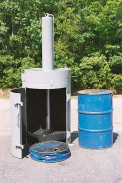

Probably nothing conjures up as strong an impression of toxic waste as abandoned 55-gal steel drums - even if the drums are empty. Companies often find it difficult — or at least expensive — to dispose of empty steel drums. And if they find a landfill that will accept the steel drums, companies find it costly to transport the drums, not because they are heavy, but because they take up so much space. High transportation charges also make empty drums less practical to sell as scrap. Enter the Model 7000 drum crusher from Drumbeaters of America Inc., Elburn, Ill.
The Model 7000 drum crusher uses a 6-in. bore hydraulic cylinder to reduce drums to as little as one-eighth their original size, which makes it much more economical and practical to recycle steel drums as scrap. The standard in-plant drum crusher uses a 5-, 7.5-, or 10-hp electric motor to drive a pump that delivers 12, 15, or 20 gpm, respectively. The difference between each size is cycle time; the 5-hp size requires 70 sec to crush a drum, and the 7.5- and 10-hp sizes require 55 and 38 sec, respectively. With a relief valve setting of 3000 psi, all sizes produce a crushing force of up to 85,000 lb. An optional model with a 7-in. bore cylinder delivers up to 115,000 lb at 3000 psi.
MacMillan Hydraulic Engineering Corp., Skokie, Ill., builds the hydraulic power units (HPUs) and supplies many of the hydraulic components to Drumbeaters. Robert MacMillin, president of MacMillin Hydraulic Engineering, says that users want a machine that crushes drums quickly, is reliable, and will last a long time. Also, they are not willing to spend a lot of money for a machine that basically processes scrap. Therefore, he says he chose to use a high-low pump that operates at high volume and low pressure when no or little load is encountered. Once fluid pressure increases due to resistance from the load, the pump shifts to a low-volume, high-pressure mode.
The simplicity of the hydraulic system using manually actuated valves provides years of reliable operation. To add longevity, the hydraulic cylinder is designed to extend to only within 3 in. of the bottom of the crushing chamber. MacMillin explained that preventing the cylinder from bottoming out extends its life by eliminating end-of-stroke impact that otherwise would result.
The Model 7000 crusher easily can be moved from one location to another by a fork lift. If necessary, the HPU can be separated from the crushing chamber via quick-acting couplings or mounted remote from the crushing chamber when space is tight. For users that prefer to bring the crusher to the drums, Drumbeaters offers a trailer-mounted transportable unit. With this configuration, the hydraulic pump is driven by a gasoline or diesel engine.
Drumbeaters points out that their crushers are used for more than compressing drums. An optional triple-rinse system accessory removes fluid from drums and rinses the drum in accordance with federal regulation #40 CFR, Part 261.7. Their crushers can also be used to squeeze fluids out of filter media or for compressing waste materials into bales.
