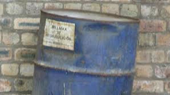

How many different types of hydraulic oil are taking up space in your oil store? If there's more than one you're not alone. I often get questions from members who'd like to consolidate their hydraulic oil inventory but aren't sure how to go about it.

As you can now see, Bob has both RO and AW hydraulic oil in three different viscosity grades - one of which is high VI. On the surface, my hunch would be that a single oil - probably AW-46, could cover his entire fleet. But to confirm this, each piece of hydraulic equipment needs to be assessed individually. The detailed procedure for doing this is explained in The Hydraulic Maintenance Handbook.
Once this has been done and the appropriate type and grade of hydraulic oil chosen, the next issue to consider is how to go about changing equipment over to the standardized oil. The first thing to understand is you ain't going to get any peace of mind from the oil companies. It's highly unlikely that any oil blender will tell you it's OK to mix their oil with a competitors. And for good reason too. When oils with different additive chemistry are mixed, there is always a risk of additive 'drop-out'.
At the very least, you should be doing a thorough oil drain and filter change as part of switching oils. But unless it's practical or possible to drain every part of the system, a small percentage of the original hydraulic oil will remain and be mixed with the new oil.
So before making the switch, it's a good idea to mix equal parts of the original and new oil in a glass jar and shake vigorously. Wait half an hour and observe the solution. Look for changes in color, clarity, viscosity and sediment. If in doubt, or for extra peace of mind, filter 100 milliliters of the old, new and mixed oils through a patch filter - noting the time taken for each. If nothing abnormal is observed, then it should be safe to proceed.
