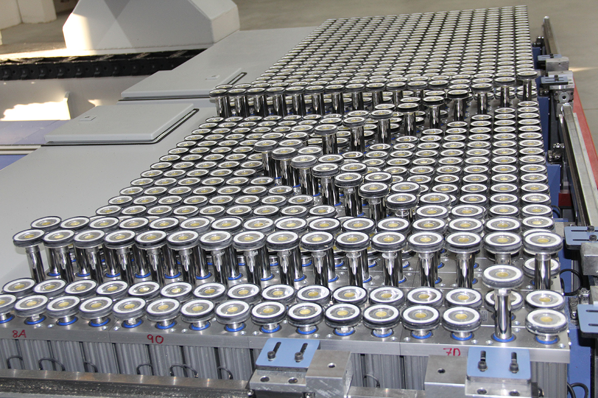

Schröder GmbH, based in Beckum, Germany, has cut its set-up times significantly for these operations with a new and unique pin table. Electronically controlled pneumatic cylinders extend within seconds, forming an inversion to the contours to be manufactured. Integrated vacuum suction cups then hold the material so machining can begin immediately.

The pin table uses 48 Aventics pneumatic cylinder/valve units and integrated vacuum cups to support and hold complex workpieces for cutting and machining.

Working with cylinder/valve unit supplier Aventics, he developed an innovative pin table for a new four-spindle portal machine from MKM International, Bad Oeynhausen, Germany. Now, with just a mouse-click, the cylinder/valve units move into position within seconds, holding the plate to be machined with integrated vacuum suction cups. The CNC program is loaded at the same time, so machining can begin without delay.
Vacuum suction cups hold workpieces in place.

To make the concept a reality, Schröder designed a modular system consisting of four mobile tables, each measuring 1,200 by 800 mm and equipped with 48 cylinder-valve units with 2-in. bore, 4-in. stroke cylinders. Two tables can be synchronized together for a larger bracing surface.

Every one of the 384 cylinder/valve units on each table is equipped with an input and output, connected to the control software via a fieldbus. A four-wire cable is all that’s needed to control and monitor an entire table. With the optimally-sealed vacuum suction cups, the new pin table achieves better results than the previous design with much lower energy consumption.
It is crucial for the workpieces to be level. Per table, the cylinder end positions are consistent within 0.01 mm. “This is important so that we can precisely mill even the smallest of profiles on the edges of the plates,” explains Schröder.
