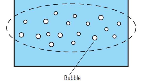

Air can be present in four forms:
  1. Free air - such as a pocket of air trapped in part of a system.
  2. Dissolved air - hydraulic oil contains between 6 and 12 percent by volume of dissolved air.
  3. Entrained air - air bubbles typically less than 1 mm in diameter dispersed in the oil.
  4. Foam - air bubbles typically greater than 1 mm in diameter that congregate on the surface of the oil.
Of these four forms, entrained air is the most problematic. Pre-filling components and proper bleeding of the hydraulic system during start-up will usually eliminate free air. Small amounts of foam are cosmetic and generally do not pose a problem. However, if large volumes of foam are present, sufficient to cause the reservoir to overflow for example, this can be a symptom of a more serious air contamination and/or oil degradation problem.

Gaseous cavitation
As pointed out above, hydraulic oil can contain up to 12 percent dissolved air by volume. Certain conditions can cause this dissolved air to come out of solution, resulting in entrained air. When hydraulic oil temperature increases or static pressure decreases, air solubility is reduced and bubbles can form within the fluid. This release of dissolved air is known as gaseous cavitation. Decrease in static pressure and subsequent release of dissolved air can occur at the pump inlet, as a result of:
  • Clogged inlet filters or suction strainers.
  • Turbulence caused by intake-line isolation valves.
  • Poorly designed inlet (diameter too small, length excessive, multiple bends).
  • Collapsed or otherwise restricted intake line.
  • Excessive lift (vertical distance between pump intake and minimum fluid level).
  • Clogged or undersized reservoir breather.
Other causes of decreased static pressure include changes in fluid velocity through conductors and orifices, flow transients and faulty or incorrectly adjusted anti-cavitation or load control valves.
