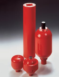

Accumulator Types
There are three commonly used types of accumulators in industrial applications: bladder, diaphragm and piston. There are several other variations.
Gas-charged bladder. Many accumulators use a rubber bladder to separate the gas and liquid. A poppet valve in the discharge port keeps the bladder from coming through the port when the pump is off. The original design, still offered by many manufacturers, is the bottom-repair style (shown above on the left). The top-repair style (the right) makes bladder replacement easier in some cases.
Gas-charged piston. A gas-charged piston accumulator has a free-floating piston with seals that separate the liquid and gas. It operates and performs similarly to the bladder type. It some advantages in certain applications, but can cost twice as much as an equal-sized bladder type.
Spring-loaded piston. Spring-loaded piston accumulators are identical to gas-charged units, except a spring forces the piston against the liquid. Its main advantage is that there is no gas to leak. A main disadvantage is that this design is not suitable for high pressure and large volume.
Diaphragm accumulators. There are also diaphragm accumulators with either resilient or metal diaphragms. They are used mainly where the stored volume is small, making them practical for many mobile applications but limiting their use in industrial applications.
