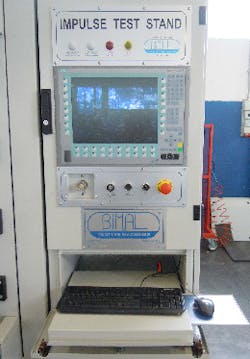

A centralized management system with a capable algorithm is required to keep each of the numerous activities in balance, guaranteeing reliable operation of the test stand. This system also monitors performance of each individual activity—upper and lower limits, as well as safety parameters.
Employing multiple systems with different management logics would be far more complex to integrate and manage. For instance, an alarm condition for the impulse test may not be the same for the heating system. In this case, the stand would halt impulse cycles and not necessarily would prevent the heating system to continue running. Furthermore, each individual system requires different settings, and in the worst-case scenario, control panels of each system would be different and located in places around the equipment or the working area.
The best design for such complex and demanding equipment is to have all of the equipment features and accessories integrated in a unique management system. All the analogic and digital signals from transducers and switches, necessary to operate it safely and efficiently, should be connected to a centralized management unit. Either by a PLC or a Compact Rio unit, this would create a reliable device capable of guaranteeing high level of safeguards and stability over time.
They also would be the unit responsible for monitoring the overall situation of the machine and to quickly intervene in case of deviation of the specs or malfunctioning of any component. This unit would also remind the operator of the maintenance schedule and time to check individual parts to help them properly maintain the equipment. Information from the test stand is always obtained from a control panel, making the operators and maintenance crew’s jobs much easier thereby reducing probability of errors.
The physical readings, provided by instruments of different systems must be available at the operator’s interface and displayed by real-time graphs that could be later acquired and saved for the testing reports and machine diagnostics.
For the equipment itself, the benefits of integration of all the systems will allow a precise setup and better control and interaction with processes to be executed. Final testing results will be better and implementation of each test will be fully automated with no intervention from the operator.
The conclusion here is that aggregating independent systems to form one equipment type is not the proper solution for this equation. Besides making managing cumbersome, this situation may increase risk of incidents in the lab area. One might consider it as a very low investment and this is probably true, but considering the ROI and the time required troubleshooting maintenance issues and programming a test, it would easily offset the initial perceived gain.
