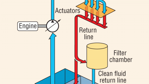

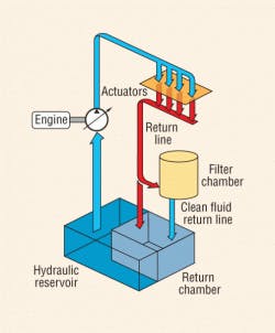

The Nephron system diverts about 3% of the hydraulic system’s return flow into its Nephron filtration chamber to eliminate contaminants 1 µm and larger. Nephron’s multi-layered filter element significantly reduces hydraulic system breakdown and maintenance costs under normal usage. Less wear and tear on the hydraulic components means more years of reliable performance.
The Nephron filtration system.
