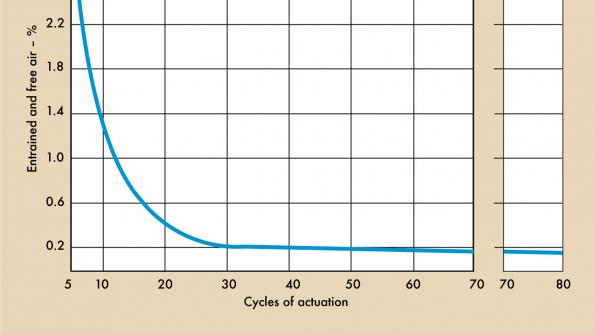

Starting with an empty actuator, flushing began at low pressure, about 300 psig. The cylinder was cycled with a 4-way valve with flow passing through an .0032-in diameter orifice at a cylinder port. The purpose of the orifice was to stimulate the area of a .0032-in diameter valve opening. After every six cycles, the test stand was shut down and an air measurement taken. Figure 4a illustrates the low pressure flushing cycles.

It was startling to discover that, with a content of only 0.17% of compressible air, the effective bulk modulus was only half of the theoretical bulk modulus. The first inclination is to take solace from the fact that careful flushing had brought the compressible air content down to 0.17%.
After flushing, test stand pressure was increased to 1000 psig. After three cycles, the air was measured and found to be .08%. After six cycles, it was 2.6% and so on, Figure 4b. In short, dissolved air came out of solution and collected in the actuator. It is this form of air that negates normal fill and flush techniques.

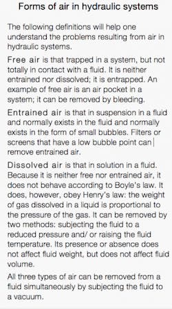

Dissolved Air Increases Weight, Not Volume
It should be emphasized that neither the presence nor the absence of dissolved air affects the volume of the oil. And test data seems to indicate that there is no effect on bulk modulus, providing the air is in solution. These facts, at first, appear paradoxical. However, if one visualizes a container filled to the brim with marbles (which represent the oil molecules), it is possible to pour in fluid (representing air) around them, or remove the fluid with no change in volume. The weight of the container changes, not the volume.

The appearance and disappearance of dissolved gases, in the form of entrained air, is an elusive phenomenon. Accelerated fluid through an orifice causes a local static pressure drop. If the pressure drops below atmospheric, dissolved gas is drawn out of solution and appears in the form of tiny bubbles (entrained air). If these bubbles do not conglomerate into larger bubbles, and if the velocity of fluid is low, most of the air bubbles are readsorbed down-stream where the static pressure is greater than atmospheric. This phenomenon agrees with Henry’s law.
An exception to this condition occurs when the fluid is accelerated above a velocity of 100 ft./sec. The air bubbles expand to larger size and are reluctant to go back into solution despite subsequent exposure to higher pressures. Erosion of materials has been known to take place in the vicinity of bubble growth. The reluctant of the bubbles to be readsorbed downstream appears strange at first until it is realized that the fluid immediately adjacent to the bubbles is undoubtedly saturated and cannot adsorb additional air.
When a stream containing bubbles is stopped suddenly, the bubbles will begin to migrate upwards and coalesce in the nearest high point. Repressurization may or may not drive the new, larger bubble back into solution.

Effects of flushing. The effect of continuous, hard-over cycling upon air content agreed well with what could be expected intuitively. In fact, the final values achieved were far lower than what would be imagined for a cylinder with “built-in air pockets. Assiduous cycling can therefore be expected to effectively purge any given system of air.
