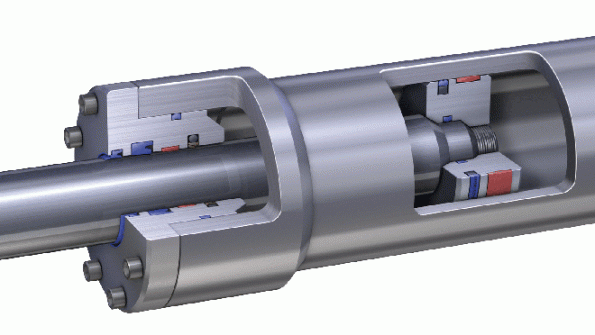

Sealing involves not only preventing fluid from escaping the hydraulic system, but also keeping contaminants from entering the system. Exclusion plays a critical role in the successful function of hydraulic systems because contaminant ingression interrupts the sealing function, which can lead to system failure. The incorrect seal choice will undoubtedly decrease the life span and reliability of the entire system.

High-pressure cylinder sealing systems normally consist of four elements: the wiper, the rod seal (or main seal), the buffer seal (or secondary seal) and the wear (or guide) bands.
Wear bands — Although the function of the wear band is not intended to provide exclusion capability for the main seal, it often captures internal debris suspended in the oil. Metal shavings not properly removed during assembly or contaminants that get into the cylinder during fluid replenishment are often sources of short term leakage if they get to the main seal.
