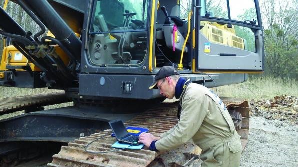

Portable contamination detection instruments make it quick and easy to assess the cleanliness of hydraulic fluid, whether the equipment is in an industrial plant or at a job site.

Portable particle counters and other diagnostic equipment have made it easy and convenient to monitor the fluid cleanliness of even non-critical equipment. In fact, many companies that have invested in their own particle counters and other instruments monitor the cleanliness of more equipment more often.
