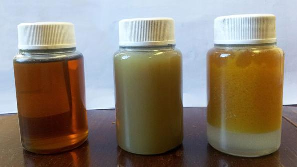

If you’ve worked with hydraulic equipment for any length of time, it’s likely you’ve come across a hydraulic system with cloudy oil. Oil becomes cloudy when it is contaminated with water above its saturation level. The saturation level is the amount of water that can dissolve in the oil’s molecular chemistry and is typically 200 to 300 ppm at 20°C (68°F) for mineral hydraulic oil.

Cloudy hydraulic oil indicates that a minimum of 200 to 300 ppm of water is present. And the higher the water concentration, the greater the reliability problem. I recently audited a hydraulic system with cloudy oil that was found to contain greater than 1% (10,000 ppm) water!

Three sample bottles contain hydraulic fluid with various concentrations of water. The sample at left contains virtually no water. The sample in the middle contains emulsified water, giving it a milky appearance. The sample at right contains fee water, which can be seen at the bottom on the bottle.
