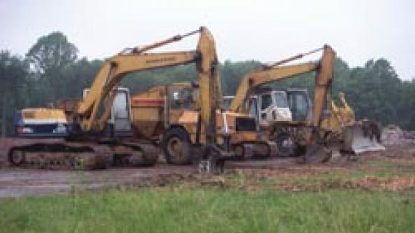

Multigrade fluids can be the single answer for mobile machinery exposed to large seasonal variations.
Very-high-viscosity-index (VHVI) fluids can improve fuel economy of mobile equipment by reducing load on the engine — especially at low ambient temperatures.
Many mobile equipment operators in the construction, forestry, mining and transportation industries across the northern U.S. and Canada continue to change out hydraulic fluids for summer and winter use. However, recent evaluations have shown that switching to a single multigrade fluid for year-round operations can improve fuel efficiency for greater cost savings while maintaining - and even improving - lubrication protection.
