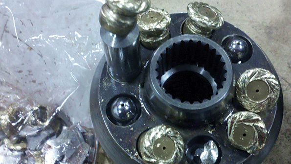

A paper mill’s pump showed extensive piston barrel and shoes damage. But what caused it?
Feb. 18, 2015
3 min read
A hydraulic power unit (HPU) in the basement of a paper mill supplied all the flow and pressure needed to run the calender section of the mill. The calender section squeezes the paper to a required thickness and smoothness by applying pressure to one movable roll that presses against a spinning, fixed roll.
The mill had a problem with the HPU’s main pump breaking into multiple small parts. Personnel determined the problem was caused by the replacement of an inlet hose that had a defective inner liner. As a result, the liner tore loose and tangled into a knot that restricted flow and starved the pump of fluid.
Mechanics replaced the pump and changed the pressure-line filter elements. They also drained the oil, cleaned the tank, and installed new, filtered oil. The HPU was designed so the pump had a flooded intake line. They filled the pump case with new oil and started the system.
After initial pump noise settled down, and the pump compensated at 2,800 psi, they opened the ball valve to a 10-gal accumulator. When the pump compensated after filling the accumulator to 2,800 psi, the pump’s shaft seal failed, and the pump housing cracked—both at the same moment.
Any idea what caused the problem?
