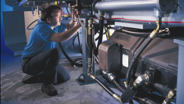

Both Sabine and Overbeeke identify noise as a major criticism by customers about hydraulics. Ironically, though, new technology now permits hydraulic systems to operate much quieter than electromechanical systems. A case in point: enclosed motor-pump assemblies, referred to as the Integrated Motor Pump (IMP) by its manufacturer, Vickers Inc., Maumee, Ohio.
Philip Swisher, director, venture development at the Vickers Advanced Technology Center, Rochester Hills, Mich., explains, “Electric motors — whether driving a hydraulic pump or electromechanical system — generate considerable noise. A motor’s cooling fan is a major contributor to noise. With an electromechanical system, add to this the noise generated by a shaft coupling, bearings, and gearbox, chain drive, or belt drive, and you’re looking at investing some serious money in sound enclosures. It should not come as a surprise that this complicates maintenance due to the additional components that must be removed and replaced to get to the motor and speed reducer.”
Swisher reveals that in the IMP, the electric motor and hydraulic pump are surrounded and cooled by hydraulic fluid and encased in a sound-dampening enclosure. Furthermore, the motor is not air cooled, but cooled by the hydraulic oil that circulates around and through it. He explains, “Air is not a particularly good heat transfer medium. Actually, it’s a better insulator than a heat conductor. This means you have to move a tremendous amount of air through a motor to provide the same amount of cooling provided by a relatively low flow of hydraulic fluid. With our oil-cooled motor, the fluid picks up heat and carries it away much more effectively. Ultimately, the more effective cooling means that the motor can be made much smaller than an air-cooled motor with the same power rating.”
To get a handle on the magnitude of the noise reduction at Eagle Precision, Sabine points out that a conventional 40-hp power unit mounted on the machine structure generated about 88 to 92 dBA of noise 3 ft from the source. Now, with a 60-hp IMP running at the same pressure and flow as the conventional power unit, noise has dropped to 78 to 80 dBA. “We attribute most of this to the IMP. However, we mount the IMP differently than we did a conventional power unit. We also installed a pulsation dampener and put a 90° hose-and-tubing assembly at the pump outlet line. While these practices have some effect, the end result is a 10-dB reduction in noise, which makes a huge difference.”
To illustrate, Sabine mentioned that after adopting these techniques for their machines, the hydraulic power unit no longer is the greatest source of noise. “Our return line filtration is accomplished in a kidney loop tapped into the reservoir. A circulating pump routes fluid from the reservoir into a filter, through a heat exchanger, and back into the reservoir. Interestingly, the motor on the kidney loop’s circulating pump makes more noise than the power unit. A conventional power unit makes so much noise that you can’t even hear the circulating pump. On machines using the IMP, we might even start looking for quieter circulating pumps.”

Once engineers at Eagle Precision decided to incorporate the IMP as a key component of their quiet package, concern shifted to how customers would react to this unconventional setup. Greg Young, technical sales representative for Berendsen Fluid Power, Stoney Creek, Ontario, shares his observations. “From a maintenance standpoint, the IMP is easier to set up than a conventional pump and motor because it comes assembled, tested, and mounts as a single, self-contained unit, so you don’t have to bother aligning the motor-topump coupling. It’s also a neater package, especially with tandem or triple pump assemblies.”
As one might expect, concerns went beyond installation. Technicians, especially at automotive plants, wanted reassurance that the IMP would not become a maintenance nightmare if it or its internal pump had to be replaced. Young continues, “At first, technicians were apprehensive because they hadn’t dealt with a liquidcooled motor, and they didn’t know what kind of mounting hardware they might encounter. But after they have changed out a pump, they realize that most of the hardware inside the enclosure is simpler than that found in a conventional pump-motor assembly. What’s more, many find it easier to work on because they don’t have to deal with coupling guards and precise alignment.” Because the IMP is manufactured as a unit, all components are designed fit together. One might conclude, then, that the extra time spent on draining and removing the enclosure would be at least partially offset by the shorter time required to replace the pump.
Sabine says he is not aware of any problems with having to replace a pump or motor. “We’ve had them in the field for about three years and are not aware of any motor failures. Replacing the pump element follows roughly the same procedure as replacing a conventional pump. Our experience has been that the oil-cooled motor of the IMP seems less likely to burn out than an air-cooled motor is. The pump is no more prone to failure than a standard pump. In fact, the IMP uses the same vane and piston pumps that can be installed conventionally.”
Sabine adds that one modification they made was to install a shutoff valve at the pump inlet. “Because we mount the pump with a flooded suction, once we remove the IMP, having the inlet line to the pump open would drain all the fluid from the reservoir. Therefore, we install a shutoff valve between the reservoir and IMP. The only precaution is that the valve get opened before starting the IMP.
“Another modification was to install a pressure gage near the pump outlet. With a conventional power unit, you can see what direction the pump and motor are rotating. But because both are enclosed in the IMP, you can’t see what direction they are turning. Consequently, we have to read the pressure gage at startup to ensure that the motor was wired for the correct direction of rotation.” Young adds that the IMP’s commissioning guide recommends using a phase meter to check direction of rotation.
“But all this attention on changing the pump should not be construed as us experiencing problems. To the contrary, pump failures we’re aware of have been caused either by a lack of maintenance or by a failure elsewhere in the hydraulic system that caused large particles to be drawn into the pump.”
IMP integration
Incorporating the Integrated Motor Pump into their machines caused engineers at Eagle Precision to rethink some of their design practices. “For example,” explains Sabine, “we used to suspend a standard pump-and-motor assembly upside-down from equipment framework to make the machine somewhat portable. In automotive plants and other applications, a bending machine gets moved periodically from location to another. The machines, therefore, must be self-contained and readily moveable. When we first started using the IMPs, we could not mount them upside-down. Therefore, to incorporate the IMP into our existing design, we had to mount it rightside-up on its own base.
“Current versions of the IMP no longer have to be mounted rightside-up, so we could mount them upside-down in the original location. We found, though, that mounting the power unit on its own base reduces noise — whether we use a conventional pump-motor or the IMP. This is because the section of 12-in. square tubing framework that supported the pump and motor actually amplified the noise emanating from the assembly. Consequently, we continue to mount all IMPs on a base that is attached to the machine’s framework, and we install vibration dampeners to isolate the assembly from the rest of the machine. Plus, mounting the power unit on its own base makes maintenance easier.”
