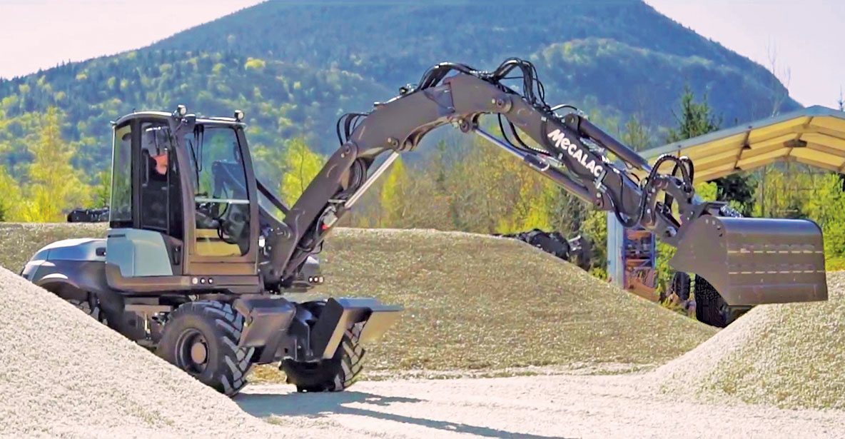

Mecalac, Annecy-le-Vieux, France, will introduce its first all-electric mini excavator next year. The machine will combine an all-electric engine with hydraulics for accomplishing work functions.
Although they are not mainstream throughout most of America, electric automobiles have become a reality. Most construction equipment, on the other hand, still relies on gas or diesel engines for power. Mecalac, Annecy-le-Vieux, France, will bring these two technologies together when it introduces its all-electric mini excavator next year. Actually, all-electric refers to eliminating the machine’s internal combustion engine; hydraulics will still be essential for accomplishing work functions. An unconfirmed report explains that the machine has two electric variable-speed motors: one to drive the wheels and the other to power hydraulic system’s main pump. This configuration conserves energy by closely matching power delivered to the hydraulics required by the load.
Mecalac’s e12 mini excavator, which will debut next year, is a modified version the company’s 12MTX that replaces the internal-combustion engine with a battery pack and electric motor to drive the machine’s hydraulic pump.
Mecalac specializes in construction equipment for urban job sites, where compact size and quiet operation are paramount. Their new e12 wheeled excavator delivers the range, performance, and compact size required to support modern urban construction sites. The e12 will essentially be an electric-powered version of their existing 12MTX mini excavator. Designers placed a lithium iron phosphate (LiFePO4) battery pack in where the internal-combustion engine had been. Electrical power then runs a variable-speed electric motor that transmits mechanical power to a geared drivetrain supplied by Dana Inc., Maumee, Ohio. The mechanical drive consists of Spicer 112 axles and a Spicer 367 shift-on-the-fly transmission.
