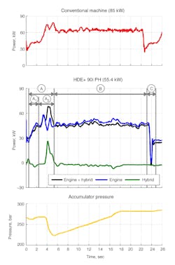

Intensive trial and measurement runs have been carried out for validating the newly developed hybrid drive. Performance of conventional machine rated at 9 tons (85-kW diesel engine) was compared to that of HAMM’s HD+ 90i PH (55.4 kW-diesel engine) hybrid machine. Examples of measured cycle data are shown in Fig. 5, with the same operating phases shown in Fig. 2.
5. Measurement results for comparing a conventional machine to a hybrid version. Signature of engine power is shown at top, with the power signature of the hybrid drive (and its components) under that, and the pressure of a typical work cycle at bottom. Note how the accumulator pressure undergoes a sharp drop from about 4 sec to 6 sec. This indicates the accumulators providing supplemental energy to the drive during peak demand.
The performance peak is smoothed in Phase A2 by the energy feed of the hybrid drive, reducing the load on the diesel engine. During the compaction process at constant travel speed, (Phase B), considerably less power is required in the hybrid drive, even though the accumulators are being charged.
During the development stage of the hydraulic hybrid system (especially in connection with the software and function) the focus for Hamm and HYDAC was centered on the end users. Both the conventional and the hybrid machines were equipped with a field data recording device to obtain an extended data basis. Therefore, fuel consumption for both machines was recorded under real operating conditions over a period of approximately 230 hr and compared to one another. Results confirmed the same fuel savings as in the test cycles. Moreover, machine operators from such companies as Strabag (Germany), NCC (Sweden), and Eiffage (France) all agreed: no difference in handling or performance was noticed in comparison to conventional machines.
