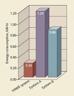

Test results compare energy consumtion of three different designs of hydraulic systems. Results at left represent power consumed by a system with a compact HPU and seat-type valves instead of spool valves.

The test compared three hydraulic systems: System A had a centralized HPU and proportional directional spool valves. System B had a centralized HPU controlled by a variable-speed motor and proportional directional spool valves, and System C had a compact HPU with seat-type directional valves.
The test parameters listed operation at 3600 hr/yr and idle times at 400 hr/yr. The test was intended to identify the power consumption and CO2 emissions. System A required 1.2 kW-hr, System B consumed up 0.86 kW-hr, and System 3, from HAWE required 0.26 kW-hr— a saving of 77% against system A and 68% against system B.
Systems A and B consumed power even during idle periods, with readings of 0.75 kW-hr and 0.4 kW-hr, respectively. The HAWE system, with seat-type directional valves, required no electric power at all when the circuit was at idle.
