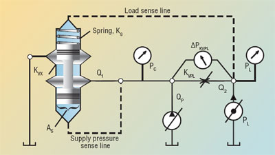

Summarizing last month’s discussion, Figure 1 serves as a starting point for explaining the test method used by manufacturers and users of unloading compensator valves and for the development of its math model. The basic test parameters are the 4-way ...
Summarizing last month’s discussion, Figure 1 serves as a starting point for explaining the test method used by manufacturers and users of unloading compensator valves and for the development of its math model. The basic test parameters are the 4-way spool position, or spool shift (KVPL in Figure 1), and the load pressure. With bias spring precompression adjusted to the desired value, the procedure involves setting the pump output flow, setting the 4-way spool at a starting position, then changing the variable load pressure. This is done while measuring flows through the compensator spool metering land, to the load, and from the pump. We also measure the compensator inlet pressure, the outlet pressure, and the differential pressure across the 4-way powered land.
Modelling from data
After adjusting the load pressure through its full range, we reduce it, and the 4-way spool is shifted to a new position and held there while the load pressure is again adjusted through the desired range. The result is a set of graphs that displays how well the load pressure remains constant as the load pressure is varied. The simulated results of this test are shown in Figure 2.
A computer program conforming to the above outline was written and has been run many times to explore those parameter values that produce better performance from the valve type in question. The output is the source for the data in Figure 2. Results are a reasonable approximation of actual test data for valves with the same parametric values.
The input data describe the valve that was simulated. It has a spool diameter of 34 in., and the pump is delivering 150 in.3/sec, which is just under 40 gpm. The bias spring has a stiffness coefficient of 250 lb/in., and precompression has been adjusted so that 40 psid is needed to just crack open the compensator spool’s metering land. Total spool travel from end to end is 0.45 in.
An additional parameter is used for investigating the use of notches on the compensator spool: circumference percentage, which is the amount of compensator spool circumference that is notched, expressed as a percentage. It is set to 40%, meaning that the notches occupy 40% of the spool’s circumference without regard to geometric details, except that they are rectangular. Triangular or circular notches cannot be investigated with this model.
The powered land coefficient will iterate from a minimum of 0.1 hole to 18.1 holes in 5 “treads.” As the spool position is iterated from full open toward valve closure, the compensator pressure, PC, will increase. The last parameter sets the exit pressure to 4000 psig. When that pressure is reached, spool position decrease ends, the program increments the powered land coefficient, and spool position is again stepped off from maximum to minimum. There is a special algorithm in the program that causes the spool potion to change more quickly at the large openings (low pressures) and more slowly at the small openings (high pressures). This ensures good data sampling in regions with the most rapid pressure changes.

Figure 1. A combination analytical schematic, cutaway diagram, and ISO symbols illustrates an unloader system that has been reduced to its most minimal form without sacrificing essential features.
