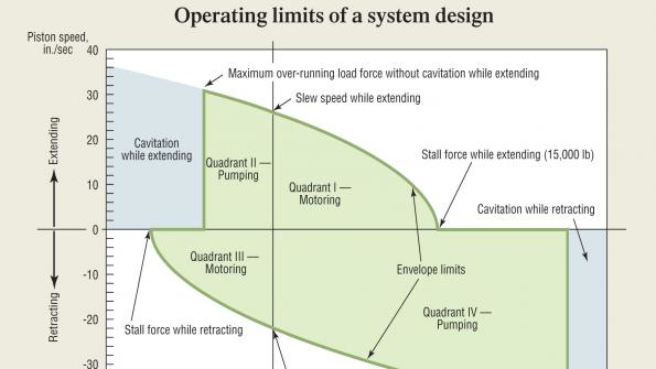

When the VCCM equation is interpreted, evaluated and graphed, the result is the force-velocity operating envelope, shown below. The force-velocity operating envelope describes the operational boundaries for a given cylinder, supply pressure and valve coefficients. The graph can be calculated for any system when the supply pressure, cylinder area, valve coefficient, valve ratio, and the cylinder area ratio are known.
These five parameters are evaluated for single rod-end cylinders under both extending and retracting conditions, then a range of values is selected for the output velocity, v. Next, the load force is calculated using the VCCM equation. When the data points are plotted, the graph displays all four quadrants of cylinder operation:

Proper system design requires that all necessary operating points lie within the operating envelope. It is normal to seek out the worst cast operating point, usually where the force-velocity product is maximum (maximum power), and ensure that the operating envelope encompasses that point. If that point is indeed the worst-case operating point, then, by definition, all other required operating points are less demanding. Therefore, they must lie within the operating envelope.
The force-velocity operating envelope, bound by the green line and shaded in color, describes the operational limits for a given cylinder, supply pressure and valve coefficients. (Click image to enlarge.)
The illustration at right represents the limits for a system that is already designed — all components and the operating pressure have been established. At design time, the components and supply pressure must be selected so that the worst-case operating point lies within the operating envelope.
The illustration represents a system that was designed to produce 15,000 lb of stall force and a slew speed of 25.5 in./sec while extending. The supply pressure is 1200 psi, the cylinder has a 4-in. bore, and the rod diameter is 3 in. This produces a retraction envelope with a stall force of 11,250 lb and a retract slew speed of about 23 in./sec.
The maximum over-running load without cavitation while extending is about 6500 lb. But while retracting, the maximum over-running load is about 26,700 lb. This defines the complete operating envelope. Any combination of force and velocity that falls within this envelope can be propelled by the system.
