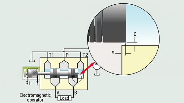

When discussing the performance of servo and proportional valves, a key characteristic is the amount of valve lap. Lap can be either under, over, or so-called zero lap, and lap refers to the amount that the spool must be shifted from center before the valve lands open. Underlap and overlap are generally unambiguous and can be recognized by a quick inspection of the flow metering characteristics for any particular valve. Quantifying them, however, is not standardized and not without its problems. Because no standard definitions exist, we’ll add the terms physical overlap and apparent overlap to the present discussion.
Physical overlap is the distance labeled X in Figure 2 whereas apparent overlap is lap based on how uniformly the flow metering passes through zero. The terms zero lap and valve opening are misleading because no universal definition exists for zero lap. Furthermore, a spool valve can never be closed.
Consider zero lap. Figure 3 shows a flow metering graph for an ideal, zero lapped valve with its curve passing straight and perfectly through zero. It is often shown this way, but, alas, such a valve does not exist in reality. A real valve can be made to closely approximate this characteristic, but it is never strictly achieved. The reason is because the valve always has some radial clearance dimension (C in Figure 2) between the spool and its bore, or sleeve. So the closest approximation to Figure 3’s idealized, zero-crossing actually occurs when there is some degree of physical overlap. In other words, some overlap is required to obtain zero lap. This may sound contradictory, but only because of the term zero lap.
I prefer the term critical lap. Critical lap is a condition, not a dimension. It is defined as: a trial-and-error valve center lap condition wherein the flow metering curve passes through zero with the minimal change in the slope (flow gain), as idealized in Figure 3. The null zone is generally taken as that region near zero flow. In this discussion, a valve that has flow metering of Figure 3 would be better described as having apparent zero lap.
