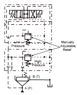

Figure 4-5. Slip-in cartridge relief valve (solenoid-operated, normally vented)
Drilled pilot passages allow fluid to flow through control orifices to the pilot area of the poppet and to the adjustable relief in the cover. As system pressure increases, the poppet sees the same pressure on both sides and stays closed . . . held by the 30-psi spring. When system pressure reaches the relief setting, the adjustable relief opens a small amount, allowing pilot flow to tank. When pilot flow to tank is greater than control orifice flow from the A port, pressure on top of the poppet lowers. Then the poppet unseats to pass excess pump flow to tank.
Figure 4-5 shows the same cartridge relief valve with a single-solenoid directional valve — or venting valve — mounted on the cover. This solenoid-operated relief holds maximum pressure with the solenoid energized and unloads the pump to tank at approximately 30 psi when the solenoid is de-energized. Reversing the solenoid coil and spring keeps the pump loaded until the venting valve is energized.

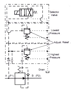

Figure 4-6. Slip-in cartridge relief valve (solenoid-operated, normally vented) for two different pressures
Figure 4-6 shows the symbol for a dual-pressure relief valve with pump unloading. Pressures are set at the two manually adjustable relief covers and the solenoids select which relief to use. When both solenoids are de-energized, the pump unloads.

Figure 4-8 shows the symbol for a relief valve with a low-pressure unloading port. Set the relief cover for maximum pressure as before. Then, when it reaches maximum pressure, the relief cartridge opens to unload the pump at approximately 30 psi. Venting pressure comes from piping the unloading port downstream of a check valve that holds fluid in the accumulator. Until there is about a 15% pressure drop in the accumulator holding circuit, the pump will stay unloaded. When pressure drops about 15%, the relief cartridge closes until system pressure reaches maximum setting again.
Figure 4-8. Slip-in cartridge -- pressure relief and unloading (infinitely variable pressure)
