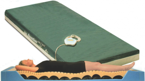

Hospitalized and infirm patients confined to bed are prone to pressure ulcers and bed sores. They’re caused by pressure on the skin at weight-bearing, bony points such as hips, heels, and elbows. One way to prevent or help heal pressure ulcers in immobilized people is with alternating air-pressure mattresses.
These dynamic-pressure mattresses contain plastic air cells that alternately inflate and deflate to relieve pressure on the body. Inflation and deflation cycles change pressure on the skin in a controlled manner and the rate can be tailored to the individual patient. Pressure mattresses also improve comfort and can aid in repositioning bed-ridden patients.
Span-America Medical Systems, Greenville, S.C., manufactures several versions of these “intelligent” mattress systems. For instance, its PressureGuard Turn Select model incorporates a microprocessorcontrolled pneumatic motion system built into the mattress that laterally rotates the patient. Air tubes inside the mattress run the length of the bed. By selectively inflating one side and deflating the other, caregivers can create customized motion patterns that roll the patient left and right at angles up to 30°, and with dwell times of 1 to 120 minutes in any position. Another version, the PressureGuard Site Select, adjusts pressure at specific body points, instead of turning the patient.

“We configure the manifold two different ways for the TurnSelect and Si teSelect ,” notes Raburn. “The difference is the TurnSelect has four tubes that run from head to foot, and the SiteSelect has tubes that run across the mattress –– three tubes per zone and four zones,” so airflow requirements are a bit different for each.
PressureGuard Turn Select mattress contains plastic tubes that run head to toe. Inflating and exhausting select tubes can roll a patient left and right at angles to 30°. Click image to enlarge.
