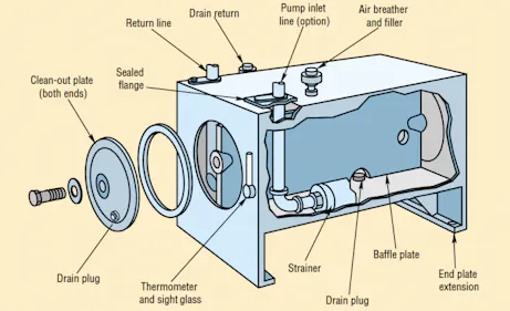

Hydraulic reservoirs store the fluid necessary for the operation of hydraulic systems. Understanding the types available and how to specify the right reservoir for a given application will help to ensure optimized performance of hydraulic components and systems.
In addition to holding in reserve enough fluid to supply a system's varying needs, hydraulic reservoirs also provide:
  • a large surface area to transfer heat from the fluid to the surrounding environment
  • enough volume to let returning fluid slow down from a high entrance velocity, enabling heavier contaminants to settle and entrained air to escape
  • a physical barrier (baffle) that separates fluid entering the reservoir from fluid entering the pump suction line
  • air space above the fluid to accept air that bubbles out of the fluid
  • access to remove used fluid and contaminants from the system and to add new fluid
  • space for hot-fluid expansion, gravity drain-back from a system during shutdown, and storage of large volumes needed intermittently during peak periods of an operating cycle, and
  • a convenient surface to mount other system components, if practical.

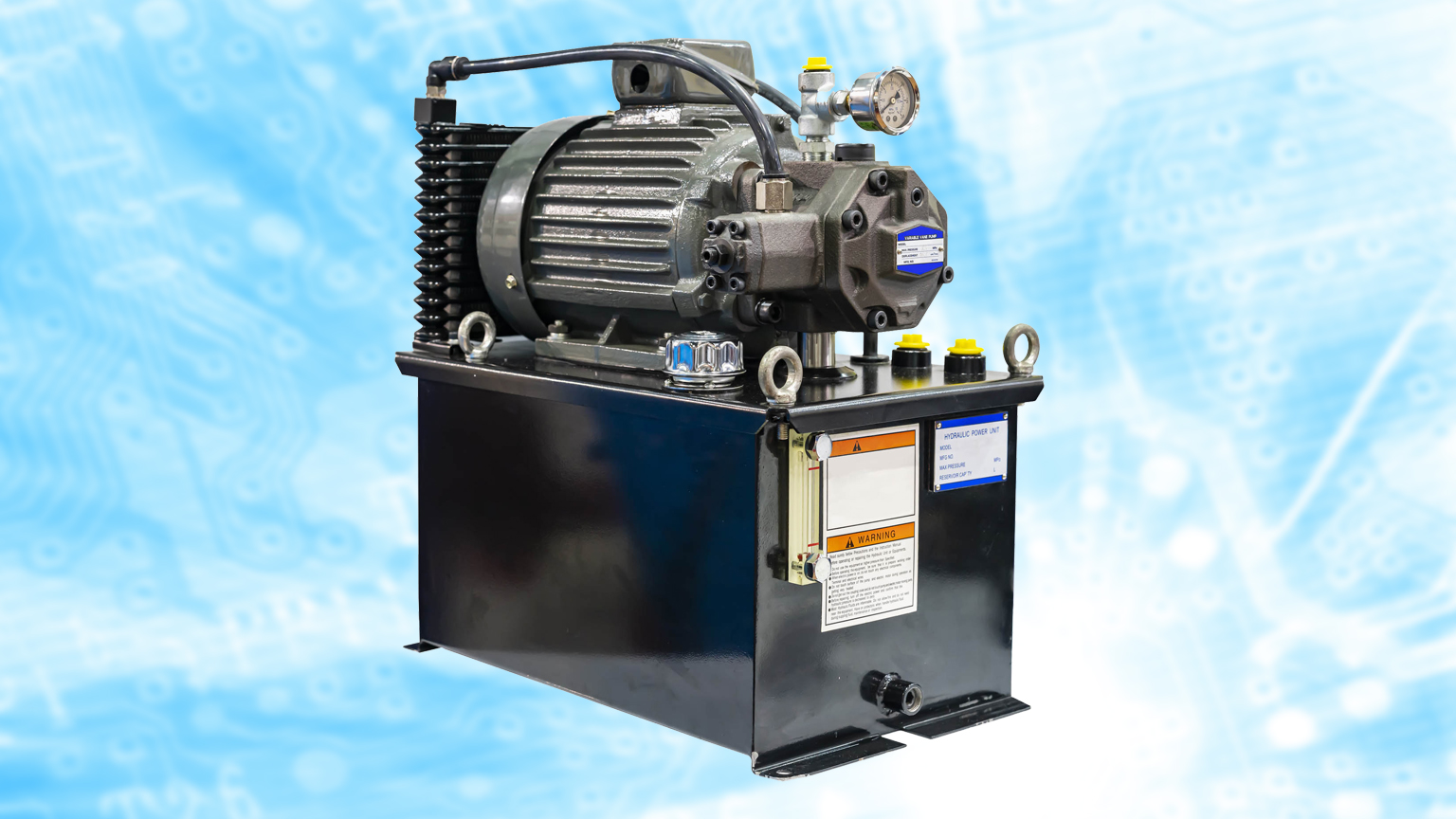

How to Size a Hydraulic Reservoir
The first variable to resolve when sizing a hydraulic reservoir is determining volume. A rule of thumb suggests that the reservoir's volume should equal three times the rated output of the system's fixed-displacement pump or mean flow rate of its variable-displacement pump. This means a system using a 5-gpm pump should have a 15-gal. reservoir. The rule suggests an adequate volume to allow the fluid to rest between work cycles for heat dissipation, contaminant settling, and deaeration.
Keep in mind that this is only a rule of thumb for initial sizing. In fact, the National Fluid Power Association's (NFPA) Recommended Practice states, "Previously, three times the pump capacity had been recommended. Due to today's system technology, design objectives have changed for economic reasons, such as space saving, minimizing oil usage, and overall system cost reductions."
Whether or not you choose to adhere to the traditional rule of thumb or follow the trend toward smaller reservoirs, be aware of parameters that may influence the reservoir size required. For example, some circuit components such as large accumulators or cylinders may involve large volumes of fluid. Therefore, a larger hydraulic reservoir may have to be specified so fluid level does not drop below the pump inlet regardless of pump flow.
Systems exposed to high ambient temperatures require a larger reservoir unless they incorporate a heat exchanger. Be sure to consider the substantial heat that can be generated within a hydraulic system. This heat is generated when the hydraulic system produces more power than is consumed by the load. A system operating for significant periods with pressurized fluid passing over a relief valve is a common example.
Reservoir size, therefore, often is determined primarily by the combination of highest fluid temperature and highest ambient temperature. All else being equal, the smaller the temperature difference between the two, the larger the surface area (and, therefore, volume) required to dissipate heat from fluid to the surrounding environment. Of course, if ambient temperature exceeds fluid temperature, a water-cooled or remote-mounted heat exchanger will be needed to cool the fluid.
For applications where space conservation is important, heat exchangers can reduce hydraulic reservoir size (and cost) dramatically. Keep in mind that the reservoir may not be full at all times, so it may not be dissipating heat through its full surface area.
The reservoir should contain additional space equal to at least 10% of its fluid capacity. This allows for thermal expansion of the fluid and gravity drain-back during shutdown, yet still provides a free fluid surface for deaeration. In any event, NFPA/T3.16.2 requires that maximum fluid capacity of the reservoir be marked permanently on its top plate.

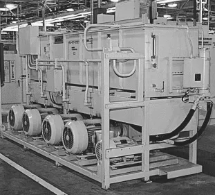

Hydraulic reservoirs are available in various design configurations. Rectangular reservoirs are a common type which traditionally have a hydraulic power unit comprised of a pump, electric motor, and other components mounted on top of the hydraulic reservoir tank. Therefore, the top of the reservoir must be structurally rigid enough to support these components, maintain alignments, and minimize vibration. An auxiliary plate may be mounted on top of the reservoir to meet these objectives. A big advantage of this configuration is that it allows easy access to the pump, motor, and accessories.
A current design trend has the electric motor mounted vertically, with the pump submerged in hydraulic fluid as seen in Figure 2 below. This conserves space, because the hydraulic reservoir can be made deeper and take up less floor space than one with traditional "bathtub" proportions. The submerged-pump design also eliminates external pump leakage, because any fluid leaking from the pump flows directly into the reservoir. In addition, the power unit is quieter, because the hydraulic fluid tends to damp pump noise.
An alternate configuration positions the hydraulic reservoir above the pump and motor as shown in Figure 3 below. This overhead configuration provides the advantage of combining atmospheric pressure and the weight of the fluid column to flood (force fluid into) the pump inlet, which helps prevent cavitation. The reservoir's top cover can be removed to service internal components without disturbing the pump and motor.
The overhead reservoir may cause a problem with gravity-return drain lines, so an auxiliary pump may be needed to route fluid up to the reservoir. When noise is a problem, overhead hydraulic tanks provide the most convenient way to enclose the pump and electric motor within a noise suppression chamber.
Many applications use hydraulic reservoirs that combine characteristics of the different configurations. For example, an L-shaped reservoir combines the advantages of top- and base-mounted reservoirs a flooded pump inlet and easy accessibility of components.
Reservoirs can also be pressurized to flood the pump. This pressure can come from an external source or from trapped air and fluid thermal expansion. A pressure-control valve allows filtered air to enter the reservoir when the fluid cools but prevents its release unless air inside reaches a threshold pressure.

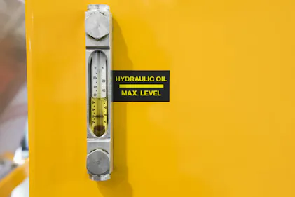

Fluid must be added to the hydraulic reservoir at startup, after cleanout, and to make up for losses. Two filler openings should permit reasonably rapid filling (at least 5 gpm each), intercept large contaminant particles from the new fluid, and either seal when closed or filter incoming air if vented as a breather. The openings should be on opposite sides or ends of the reservoir. Metal strainer screens of 30-mesh or finer should have internal metal guards and be attached so tools are necessary for removal. The filler cover should be permanently attached, and if it does not include a breather, a separate breather should be specified. In either case, 40-µm air filtration should be provided.
In addition to slowing down fluid returning to the reservoir, reducing foaming and pump cavitation from flow disturbances at the inlet, and providing fluid mixing without agitation, flow diffusers also reduce noise and the need for baffling. They are especially effective in small reservoirs with high flows and in deep reservoirs with a small floor area.
A fluid-level indicator should be located at each filler. Indicators should have high and low levels marked against a contrasting background to help maintain appropriate fluid level. An electronic level indicator can serve as a more sophisticated alternative. These devices use a variety of means to measure liquid level. Transducers produce a continuous output, and switches signal when liquid reaches a predetermined high or low level.
Fluid temperature measurement is not required by the NFPA standard, but a selection of thermometers is available, many in the same housing as the fluid-level indicator. (If high fluid temperature is a continuing problem, the heat source in the circuit should be identified and removed.) As with level indicators, a variety of electronic temperature indicators are available.
In either case, signals generated by these devices are routed to a display or control panel to provide operators with an indication of fluid status. Wiring a level or temperature switch into the machine's control can prevent equipment damage by shutting down the machine if fluid reaches a dangerously low level or high temperature.

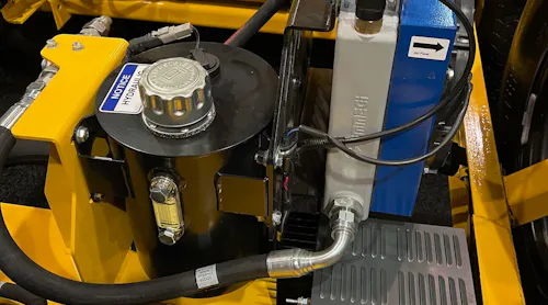

Hydraulic Reservoirs for Mobile Equipment
Mobile hydraulic reservoirs are expected to perform the same functions as their industrial counterparts — but usually under more adverse and less predictable operating conditions. Machine motion (which makes complex baffling systems necessary to prevent fluid sloshing) and extreme ambient temperatures are just two examples of the special problems designers of hydraulic systems for mobile equipment face.
Size and weight limitations may require mobile equipment to operate with reservoirs as small as the volume a pump discharges in a minute. This is roughly a third the size of a reservoir traditionally used in an industrial application. The space and shape limitations mobile equipment places on reservoirs requires that they often be custom designed. Cost, size, and weight must be minimized, while still maintaining adequate performance and efficiency.

How to Choose Between Vented or Pressurized Reservoirs
An important design consideration is whether to specify a vented or pressurized reservoir. The major deciding factors are the location and inlet requirements of the pumps. The fluid level of the reservoir in many mobile applications is below the pump inlet. At best, if there is vacuum at the pump inlet, the pump may have to be derated. If inlet line losses are great enough, cavitation will occur. In these cases, pressurizing the reservoir will help maintain pump performance.
Any of three methods can be used to pressurize a reservoir on most mobile equipment:
  1. Use regulated compressed air from a machine's pneumatic system — the most effective method — if available.
  2. Trap the air within the reservoir clearance volume (above the fluid) and depend on thermal expansion of the fluid to compress this air, and thus pressurize the reservoir. A reservoir pressure cap holds pressure within the tank and relieves excess pressure.
  3. Tap pressurized air from the scavenge pump of a two-cycle diesel engine.
