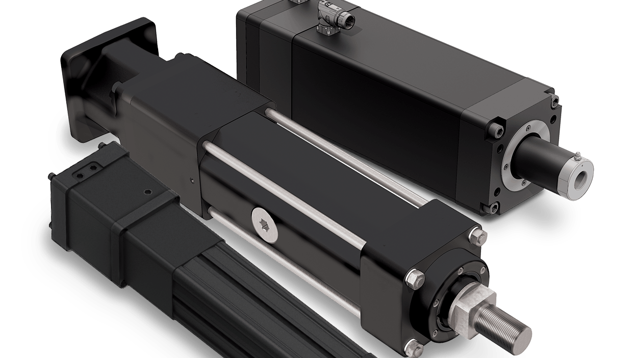

Tolomatic
Electric actuators provide precision and reliability in a range of applications
