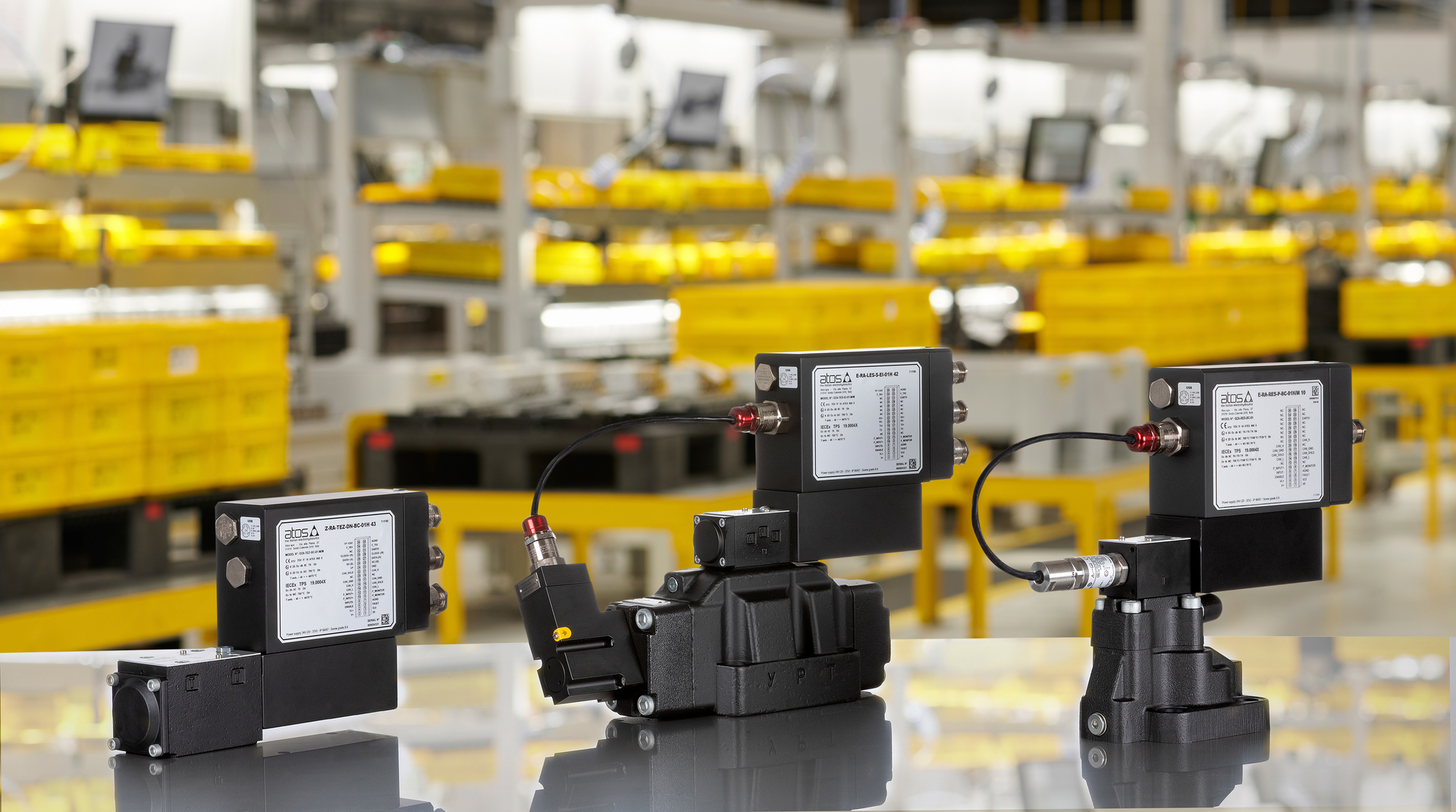

Atos has developed a range of explosion-proof electrohydraulic components which benefit use in a range of applications such as mooring systems for oil & gas vessels. They are designed to provide high-performance control and simplified maintenance while offering the corrosion resistance and heavy equipment handling required of the application.
Features of the explosion-proof electrohydraulics include:
  • provides high-performance motion control
  • high corrosion resistance via zinc-based surface treatment, reaching up to 600 hours in salt-spray test
  • on-board digital technology enables development of smart systems
  • industry certifications such as SIL2/SIL3 according to IEC 61508, TÜV, DEKRA, UL and more.
Complete Range of Rugged Electrohydraulics
The portfolio of explosion-proof electrohydraulics includes individual components  such as pumps, proportional and on-off valves and cylinders — as well as complete systems. On-board electronics enable these electrohydraulic components to provide a high level of accuracy for motion control as well as the ability to create smart systems.
The proportional valves, for instance, feature on-board digital technology including a built-in oscilloscope for advanced diagnostics, high performance axis and p/Q control. Inductive proximity sensors are integrated into the portfolio's directional valves which allows monitoring of the spool position.
To ensure high corrosion resistance in marine and other harsh applications where explosion-proof hydraulics are required, Atos utilizes a zinc-based surface treatment on its electrohydraulic components. It has demonstrated the ability to protect components up to 600 hours in salt spray tests. For applications where higher corrosion resistance is required, components are made using stainless steel.
Atos' explosion-proof components meet various industry certifications, as well, further ensuring their ability to meet the requirements of harsh environment applications. These include ATEX, TÜV, DEKRA, UL, CSA, ABS, BV, DNV GL, RINA. The solenoid valves in the range are certified up to SIL2/SIL3 according to IEC 61508.
