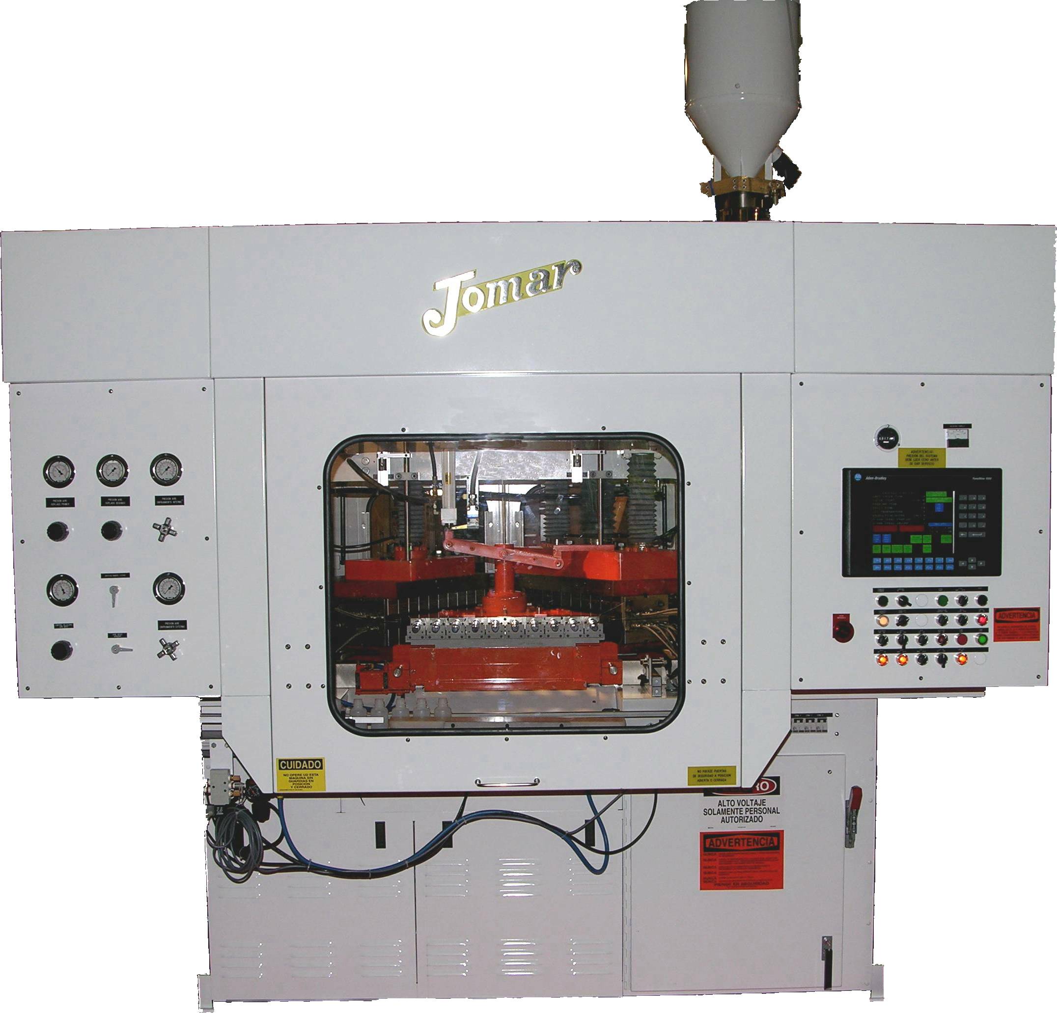

Jomar Corp.’s newest 85S Model of IntelliDrive injection blow molding (IBM) machines is equipped with a Syntronix servo-driven hydraulic system from Bosch Rexroth.

Injection blow molding machines from Jomar Corp are used by manufacturers to produce thin-walled items like bottles and containers used in pharmaceutical, health care, personal care, beauty, food, beverage, and household-goods markets. Jomar Corp.’s newest 85S Model of IntelliDrive injection blow molding (IBM) machines is equipped with a Syntronix servo-driven hydraulic system from Bosch Rexroth, boosting efficiency by 40%-50% compared to conventional drives. The new system is the first of its kind to incorporate several new-to-market components in a unique, space-saving design.
The design takes high pressures into consideration as the plastifier's screw drives inject melted plastic into the molds, and compressed air is introduced in the mold to create a vacancy. The molds are held tightly shut by a clamp, which is opened and closed over millions of cycles to form and release the products. To supply these pressures with higher efficiency, Jomar and Bosch Rexroth investigated a closed-loop, servo-driven hydraulic system that would replace the all-electric platform used in previous models. The new system combines intelligent digital controls with a 4-quadrant pump-servo motor system that regulates the speed and flow of hydraulic oil.
