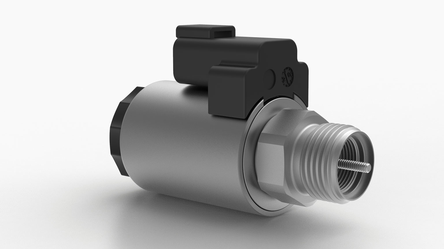

CompAct adds a new wrinkle to push-pull technology.
The CompAct technology leverages an embedded magnet design for push-pull actuation in half the space of traditional push-pull solenoids. The 37 mm series of CompAct technology is now available with plans to expand to larger sizes in 2022.
CompAct differs from traditional push-pull technology in both size and performance. The package size of CompAct is up to 50% smaller because of its single coil design and the entire unit is plated for up to 1,000 hours corrosion resistance per ASTM B117. This innovation provides an increased level of performance with proportional repeatability within less than 1% of full stroke.
