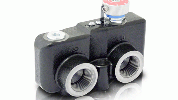

The VFD190 Series in-line flow-control valve regulates motor or cylinder speed.
The VFD190 Series in-line flow-control valve regulates motor or cylinder speed. Large 1-in. port and optimized design provides low-pressure drop, cutting heat generation and fuel consumption. The three-port variable priority flow divider is immune to rapid changes in load. Adaptive pressure compensation allows regulated and bypass flows to be used to drive separate circuits. The VFD190 is rated to 50-gpm inlet flow, at pressures to 6,000 psi.
