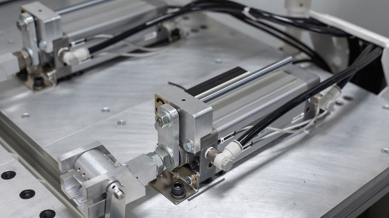

Several factors should be taken into account when selecting pneumatics as a means of power transmission.
Pneumatics is one of the two methods used to transmit power within the field of fluid power. While its counterpart hydraulics uses a liquid, pneumatics utilizes gas to move power from one location to another.
Compressed air is typically used for pneumatic systems, but nitrogen and other inert gases can also be used depending on the application requirements. A typical pneumatic system uses a compressor to pump air into a receiver which is able to hold a large volume of air to then be used by the system when needed.
Although hydraulics is known for its higher power density, pneumatics offers its own benefits and is a widely used technology. “Usually, it comes down to total cost of ownership. If you don't need the heavy loads possible with hydraulics, you can still get high speed with pneumatics but lower total cost of ownership,” explained Jon Jensen (no relation to author), CFPPS, CFPECS & CFPAI, Industry Projects Manager – Energy at SMC Corporation of America in an interview with Power & Motion.

According to Jensen, the lower cost and longevity of pneumatic components can make them a more desirable option than hydraulic or electric actuators in many applications. The amount of force required in an application is the key determining factor for choosing pneumatics or hydraulics. “Generally, the added cost of hydraulics is not needed unless the forces are higher,” said Jensen. “If you’re moving things in the range of a few pounds then pneumatics is a good choice.”
He noted hydraulics typically come into play when loads reach several hundred pounds or more as at that point it does not work well to move something pneumatically. Control is better within hydraulic systems because the fluid does not compress which is beneficial when moving something heavy as it prevents jerking or bouncing while moving.

If choosing to use pneumatics, what are some considerations design teams should keep in mind? According to Jensen, right sizing the pneumatic system is vital to ensuring its efficiency. All components in the system need to be sized correctly, he said.
A common practice has been oversizing components "just in case" but Jensen said that leads to larger volumes to fill which makes a system less efficient. Even the size of tubing and hoses needs to be considered because the more volume that needs to be filled the higher the operating costs. As such, it is important to be “very particular about sizing things correctly,” he said.
Another suggested best practice is to not run everything at the same pressure. This means designing the system so the correct pressure for each part of the machine is adjusted and maintained. If something is moving it does not usually need the same force in both directions. “Usually, it’s pushing something and then pulling back and not doing any work,” said Jensen. “We can adjust the pressure and often reduce the cost of the air by 50% for that application. There are a lot of little things you can do that add up to real efficiencies.”
In general, he said it is important to get pressure and flow in the right place and for end users to monitor them both to ensure efficient operation.
