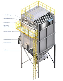

But which components can make the biggest impact? Let’s think about how dust collectors work.
As a dust collector operates, its filters catch dust. This accumulated dust forms a dense cake that can block filters and decrease system efficiency. In reverse pulse jet dust collectors, a reverse jet bag filter cleaning system delivers a burst of compressed air that sends a shockwave through the filters, breaking up dust cakes. The dust then falls out of the collector and into a hopper. By effectively clearing dust from filters, this system improves filter and overall system efficiency, and extends filter life.
In a practical example, most aggregate applications use a dust collection system to collect aggregate particulates produced from crushed limestone. The collected particulates are then sold in bulk for a significant return of investment, which is one of the many ways the aggregates industry maximizes efficiency and maintains quality. The crushed limestone dust particulates are then used to produce a byproduct called self-consolidating concrete. This resulting concrete mixture has a higher flow rate, and its coarse aggregates don’t separate from the cement’s adhesive properties. This helps to keep the concrete strong while making it easier to work with in many different construction applications.
So what makes the reverse jet bag filter cleaning system effective enough for even heavy-duty aggregate applications? The critical component that delivers the high burst of compressed air that ultimately cleans filters is a pulse valve.
Dust Collector Efficiency

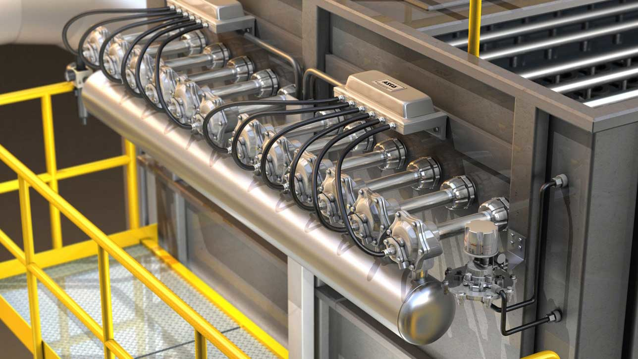

The number of pulse valves needed depends on dust collector size. Some dust collectors may have a few, while others can each have 50 or more. But no matter how many pulse valves a dust collector has, they operate in much the same way: A line of pulse valves activates in sequence to remove dust from filters. The pulse frequency depends on application needs.
The latest pulse valves are designed to extend component and system life, make installation and maintenance easy and reduce air consumption. To access these efficiency benefits, it’s important to prioritize five features when specifying a pulse valve for a dust collector system.
